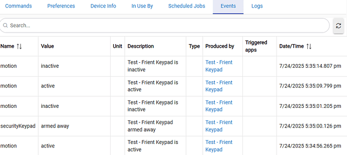

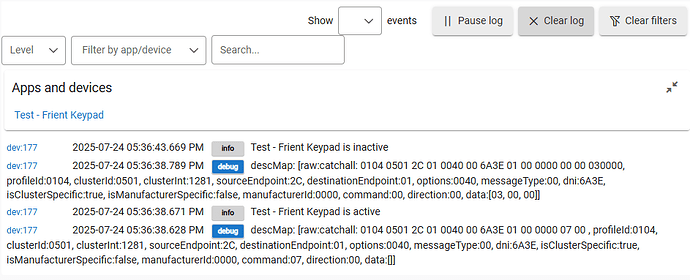

Below is a picture of logs :

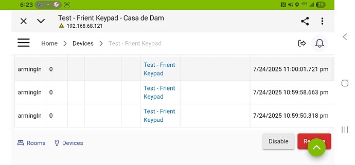

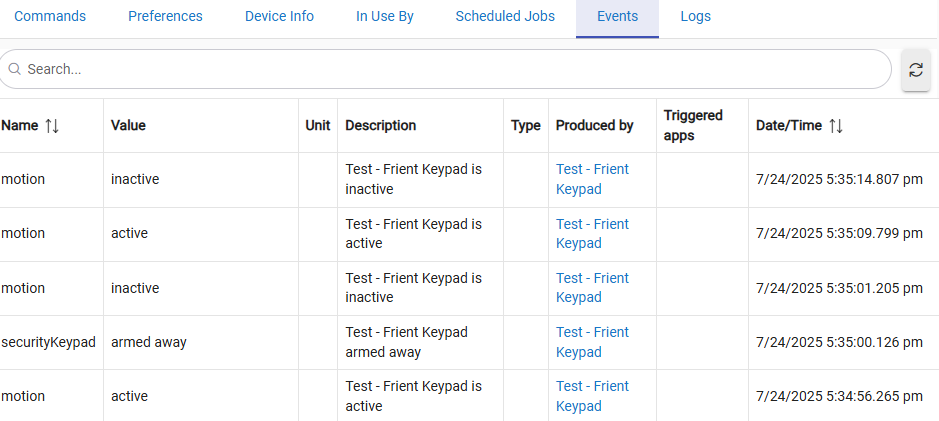

Below is a picture of events :

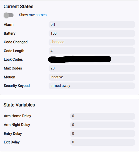

Below is a picture of attributes :

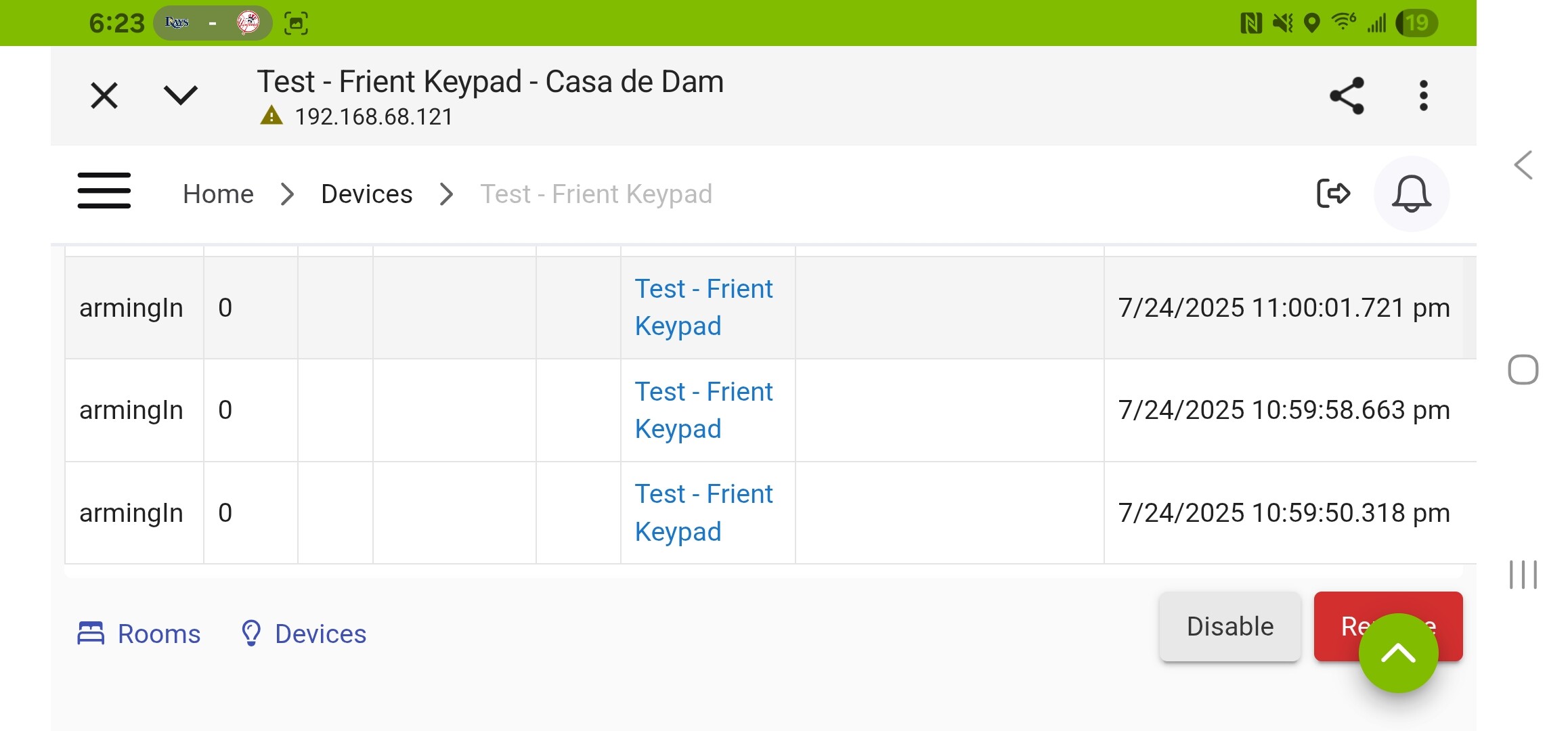

Below is a picture of the driver :

Can you post a screenshot of the driver state variables?
Looking at other keypad code, none of them send an event for armingIn, so I'm not sure what you're expectation or use case for this was/is
Driver state variables are in a picture above. Do you mean other variables or the preferences?

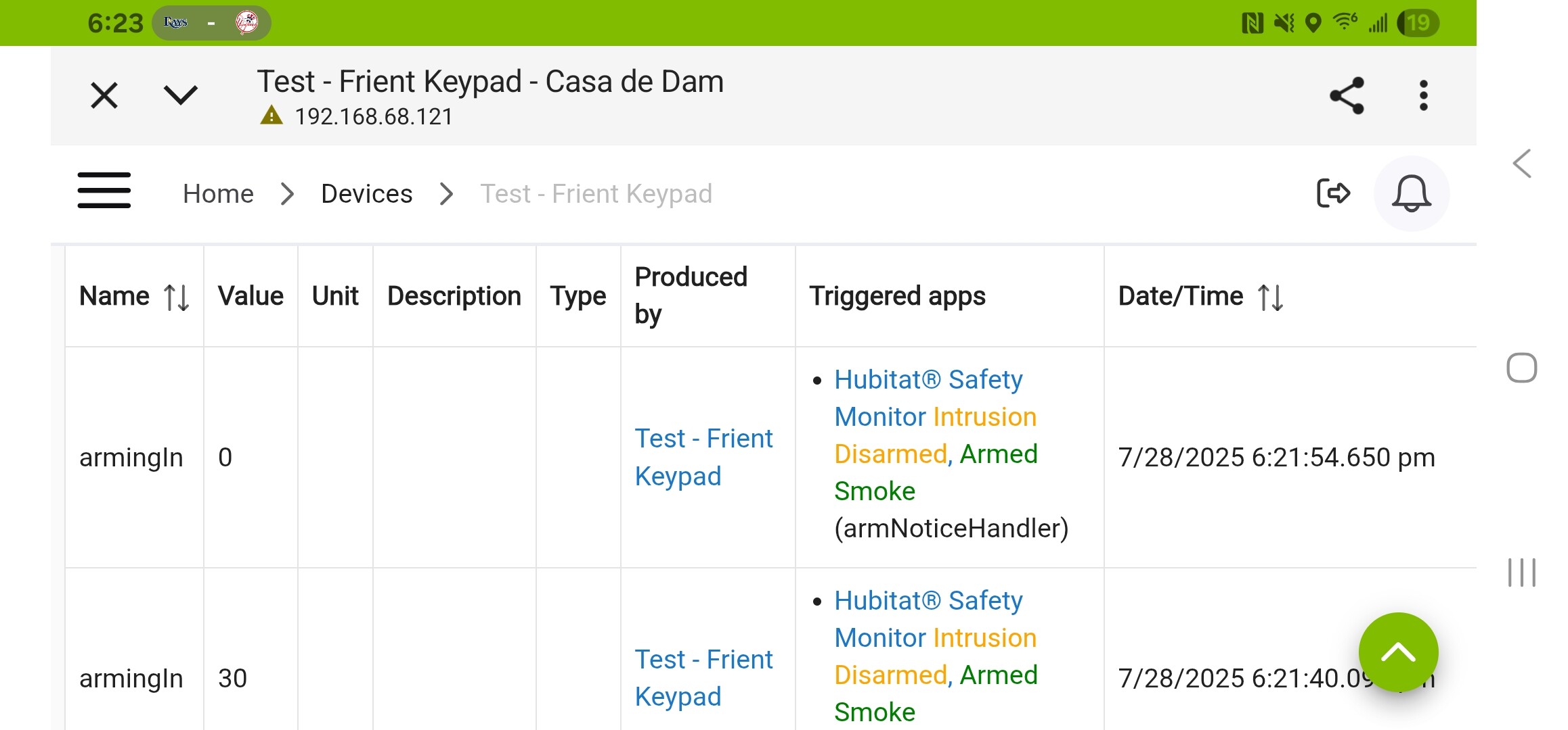

Well... I dont know what is going on... but it is now sending the armingIn events and controlling HSM! It wasnt doing it when I 1st paired it, and I tried 2 different hubs! This makes no sense... it started hours after I sent that 1st message.
Arming in events are sent one of two ways, with HSM if arm delays are configured, or without HSM if the the preferences are enabled, and the commands are used to set the values.
