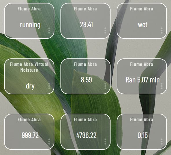

Is there a way to get labels on more of the attributes? I added a bunch of attributes to my "abracadabra flume"
but most of them are unlabeled... I assume this is an HE Dashboard limitation.
The Hubitat dashboard shows the attribute name for me when I create a tile. I suspect something in your custom formatting for those tiles is hiding them. Is that the native Hubitat dashboard app or something else?
For example (different driver, same point):
Yes - I'm using a dashboard mod called "Smartly" that was developed some time back by individuals who are no longer participating in the forum (they are working on their own smart hub and were banished...). Gives you mouse-control - drag and drop and resize, which is very nice, and prettier too if you want to invest time in customizing.
So that must be why I'm losing the attribute name. Thanks.

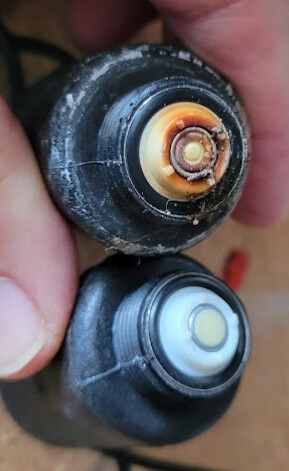

So I was an hour or two in the front yard today playing "Which Solenoid is the Naughty Solenoid." ![]()
One solenoid was a mess, obviously not in good shape. Old and new below...
A second solenoid also seemed like a very good candidate to replace, but in the end I replaced two valve bodies and three solenoids altogether. Mostly because things were getting pretty old and I had the parts on hand. I know, not very scientific, should only change one thing at a time but it was late and I was just so tired of dealing w/this slow-annoying leak.
At this point there is no leak, but I am not out of the woods because the leak has been on and off again in the past few weeks.
Thanks again for pointing me at the solenoids, that is (was?!) the cause, or at least part of the cause, of my excessive liquidity. ![]()
