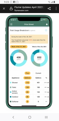

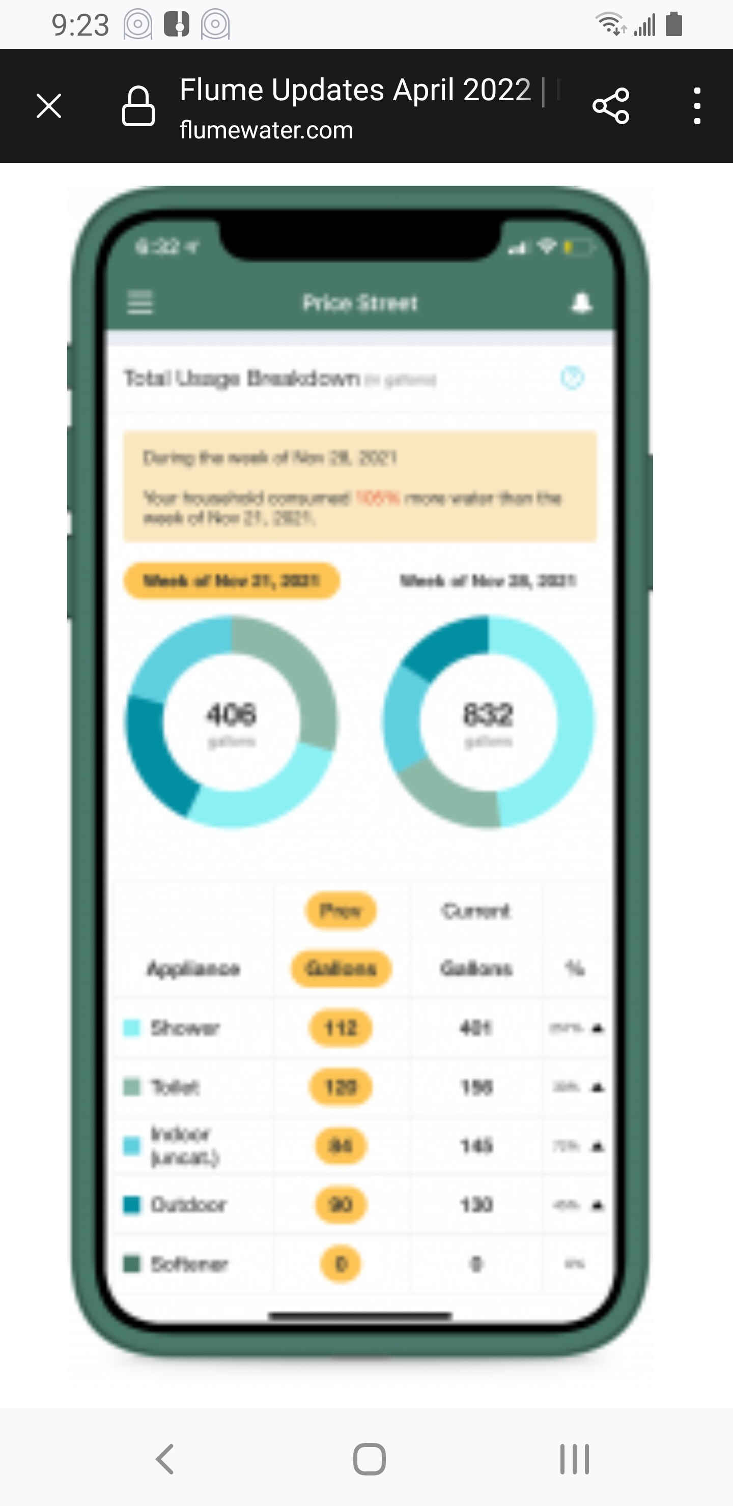

Does the water use identification work in your experience?
How does it know??
My experience with the Sense energy monitor was not amazing when it came to identifying devices.
I haven't used the water identification options yet, just too busy and my priority has been my outside irrigation.
Once some family stuff is cleared up (having to move Mom into Memory Care facility) I'll have a little more time for things like this.
I haven't tried it yet either. It's pretty new, and it wasn't clear whether it was going to be an additional subscription or not.
Based on how they described it, I assumed they had done a bunch of sampling of known use cases and are planning to use ML to analyze based on the signature of usage. Like maybe a toilet tends to be one big swoosh, while a shower is a long steady flow, while sprinklers look like repeated long steady flows. Just a guess on how it will work.
Also, this type of functionality is really only possible in a cloud implementation because of the amount of data and computing that are necessary for the analysis.
They also ask questions in the app about usage, to help them categorize stuff.
I did the 30 day trial, and canceled .. I may do the lifetime because its 1 and done, and gets me better features when/if they release it. As @tomw mentioned, they guess at the usage, and then you do surveys to increase its knowledge of the usage. Its pretty generic (shower, outdoor, washer, etc) ... I didnt find it useful, and it often miscategorized things as outside, when there was def. no outside activity
