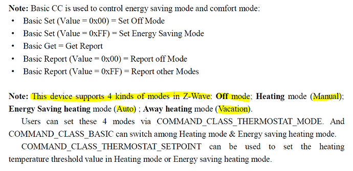

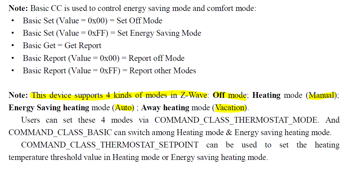

I've just started using my MCO thermostat for underfloor heating. So far so good.
I'm using Thermostat Scheduler to manage the setpoints. Also I'm using the built-in Generic Z-Wave Thermostat driver.
All worked fine once I set the MCO into Manual mode.
Simon

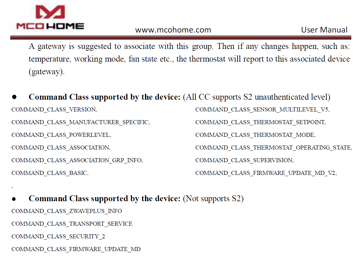

I'm bench testing the hot water version at the moment and pretty much confirm everyone's findings. Their is a battery component for some reason, it's chatty unless you change the parameters and it needs to be manual mode for HE to control it.
The only modes I can control from HE is off or manual. I'm disappointed that if the device is set to auto (running it's own schedule), I can not override it from HE. i.e. if I want the temp a little hotter until it hits the next time point.
What are they using: WiFi, Zigbee, Z-Wave for communication? Thanks.
They use a custom wireless protocol (modified ZigBee I believe) back to the hub, and the hub is LAN controlled, hence fully local
is it not the intention to use the timetable from Hubitat with possibly an override from the hub or from the device itself?
I guess but it would of been nice, just in case my hub dies my heating is not that greatly affected. I do try to have a manual backup.
Okay, I get it, the fact that it can work on its own, eventually after some configuration on the device, should be reassuring
yeah, it's a small price to pay at the moment to be cloud free and I'm sure in the future it will changed as there will be something new :rofl:
I wonder if this is a Hubitat driver issue or a device Issue, If I check the manual, it should be possible....
