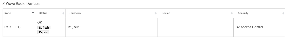

Is this a ghost device? If yes, how can I remove/delete it from the hub please?
no that is the hub itself always ignore node 1
This one is just with empty in/out clusters. Rest of the devices seems to be ok just are in the status FAILED like those 2 examples from my hub.

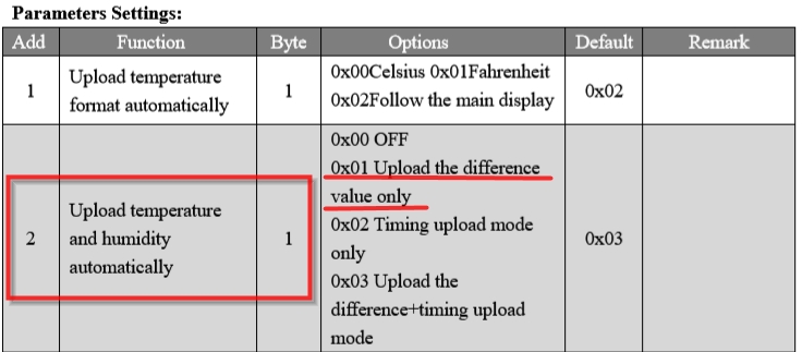

I figured out the issue with MCO thermostats that caused serious performance issues on my HE C-7.
When I enabled all type of logging on thermostats I found out that they are (8 thermostats) generating tons of log entries in a few seconds 24/7 what affected HE performance.
When I read carrefully the MCO thermostat docu I found out there is a default parameter that report humidity and temperature periodically also when no changes (value) on them so I decided to change the default parameter to send update to hub just in case temp and humidity changed.
Below screenshot parameter was changed from 2 - 1 - 3 to 2 - 1 -1.
2 - 1 - 3 (default) -> Upload temperature and humidity automatically -> Upload the difference+timing upload mode
2 - 1- 1 (new) -> Upload temperature and humidity automatically -> Upload the difference value only
I did the same change on all 8 thermostats and everything start properly running no lag no delays. Switches (20+) working almost immediately and also the contact sensors reporting changes immediately.
Maybe described change also fix your issue.

To set the parameter I used the Basic Z-Wave Tool.
