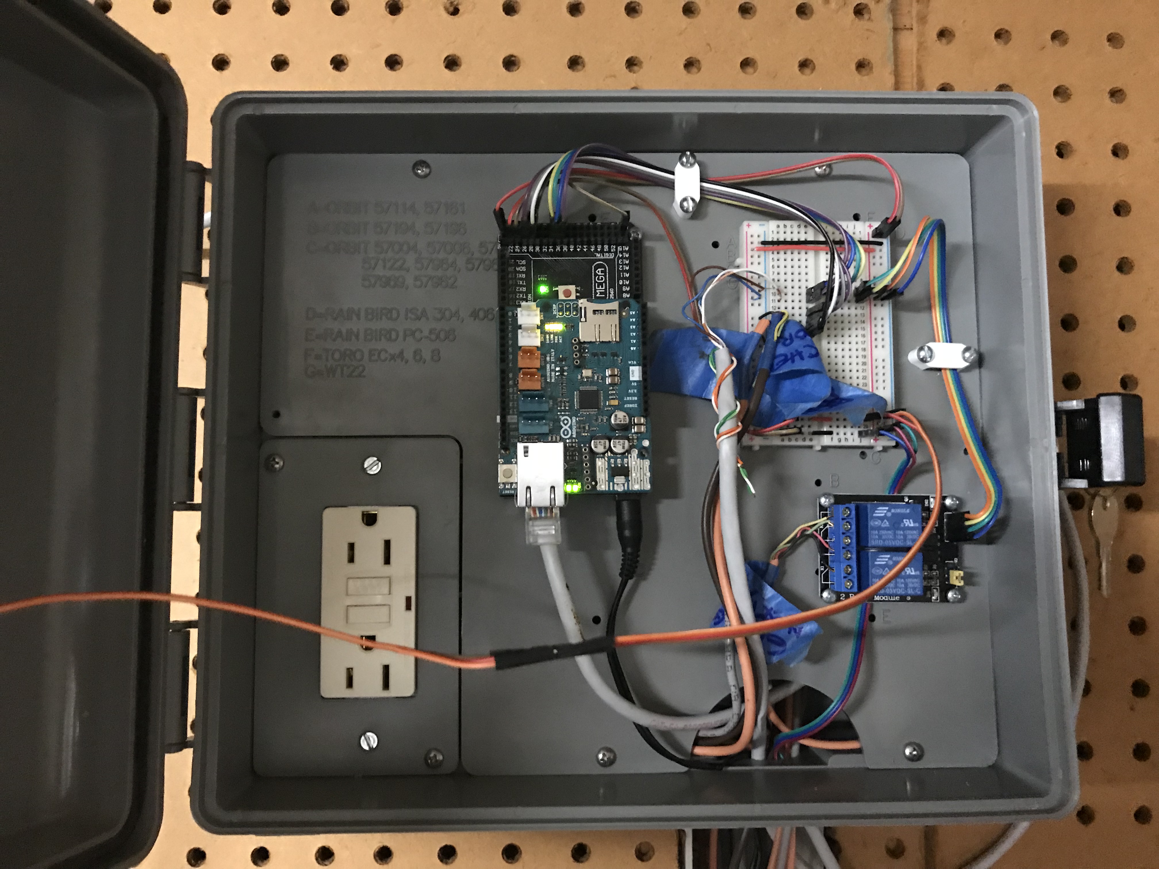

So, after just over 1 week of owning a new Hubitat Elevation Hub, I have finally completed my first major migration of devices from ST. Unlike most users, a large number of my devices are actually hard-wired sensors attached to an Arduino.
Back in 2014/2015, my son and I wrote an Arduino Library called ST_Anything for the original ST ThingShield. I have been using a ThingShield to make use of my house’s alarm system prewiring, installed when the house was built, but never used. I simply bought some recessed magnetic reed switches, and a couple of relays, a PIR motion detector, and a DHT22 Temp/Humid sensor and wired everything up to an Arduino UNO + ThingShield. That code has been running fine ever since, and I have had zero reliability issues with the Arduino/ThingShield (as long as my internet was up, and the ST cloud isn’t having a bad day…) Now performance, has been another thing completely…
Today, I converted my Arduino UNO + ThingShield to an Arduino MEGA + W5500 Ethernet Shield. I am using this to monitor and control 2 garage doors, 4 house doors, a PIR motion detector, and a DHT22 temperature/humidity sensor. I am using my HubDuino software package on the Hubitat hub, along with ST_Anything running on the Arduino.
I must say, I am extremely happy with how fast the Hubitat hub is at processing changes of state, executing rules, and triggering device updates. I have a Rule Machine rule that monitors all of the doors attached to the garage + the garage motion detector. If any of these go active, I turn on the garage overhead lighting. This used to take about 1.5 to 4 seconds on SmartThings. Now, this happens in less than 1/2 a second.
Great job, Team Hubitat! And thank you for your assistance over the past week!
Curious why you are using the Ethernet shield over the ThingShield? Is performance better? My main house Arduino currently using a ThingShield happens to be in my wiring closet and I can easily hook up to an Ethernet switch, but hoping to avoid purchasing new hardware.
I chose to go with Ethernet as I wanted to actually put my latest code into "production" at home. I had been using some very old code on the UNO/ThingShield for years without touching it. Since adding LAN connectivity to ST_Anything about a year ago, I had not yet actually run any long-term tests with in in my house (lots of hours/days/weeks on the workbench though!) So I decided to take this opportunity to give it a shot.
The ThingShield should still work fine. No reason to change that I know of, except possibly for performance. But, switching to a LAN connected device also creates a dependency on your home network that is not present with the zigbee based ThingShield. So, there are tradeoffs, I guess.
Here is what the new panel looks like:
