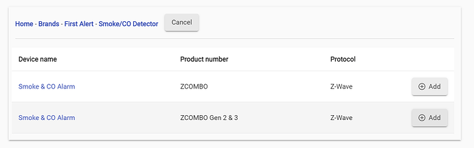

I installed some of these, but they were not detected by Hubitat as I would have expected. I just want to make sure I am not missing something.
There appears to be an entry under the First Alert manufacturer:
But, when I tried to add a device via the Gen 2 & 3 driver, nothing was detected. (Gen 2 was a couple of years ago and these are new devices, so I reckon they have to be Gen 2 or 3.)
I did a manual Zwave inclusion, not picking a driver at all, and the device was added as a generic "Device." I looked for a better driver, but the device page does not list anything for First Alert devices.
I chose "Generic Zwave Plus Smoke/CO Detector" and now the devices are reporting battery and smoke status -- but no CO. OK, CO started showing up after a few more minutes, no problem.
Anyway... Is the generic driver the best one for this device?
