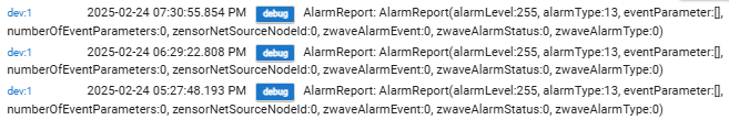

I recently upgraded my setup from C7 to C8-Pro and found that my First Alert ZCOMBO (Gen 1) Smoke/CO alarm devices report in every hour but do not appear to update the battery level using the System "Generic Z-Wave Smoke/CO Detector" driver. Example:
C8-Pro_ZCOMBO_Log

Is anyone else running into this issue, and if so, is there another driver that works with the C8 and ZCOMBO (Gen 1) devices?
