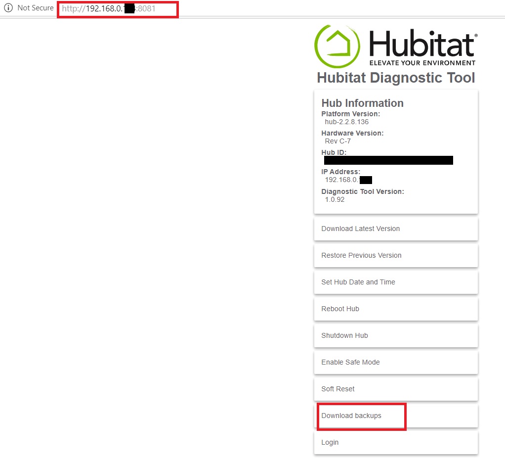

go to yourhubip:8081 Go download latest backups (go back a few days). Do another soft reset from the same page and restore from the back up you just saved. This should ensure a clean database (usually when your issue happens it's due to some kind of db corruption).

go to yourhubip:8081 and there will be several backups from the last 5 or so days. Go back several days just to be safe. Put the file where you can get to it. From the same page do another soft reset. Reapply the database you downloaded. Downloading cleans the database and ensures it's not corrupt. Normally hangs like yours are due to database corruption. The procedure I outlined cleans it up.
The other option is to restore the previous firmware, get booted back into the hub, and then do the procedure I outlined above, but then do the upgrade again. That way when the update is running, it won't be fighting with a corrupt database

My concern is that I was prompted to do the soft reset due to the "xxxx events and growing" or something similar to clear that. Won't I just be restoring that issue? I've downloaded the available backups - these are shown in the screen shot:
The bottom three are the backup I took prior to the firmware update, the backup I took before the soft reset and I'm not sure about the one marked "shutdown"

A soft reset does get rid of (reset) the hub. However, it does not remove the stored radio (AKA device) information from the hub. But you do have to run a restore to bring the database back so it knows what device is what, and restore the rules, dashboards, and so on.
It is a very safe procedure provided you have a backup, which the update procedure always prompts you to do. If you did not save this, there is a backup (there should be at least a couple) in the diagnostic menu at 192.xxx.x.xxx:8081 like rlithgow1 indicated above.
