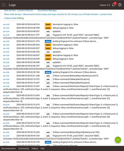

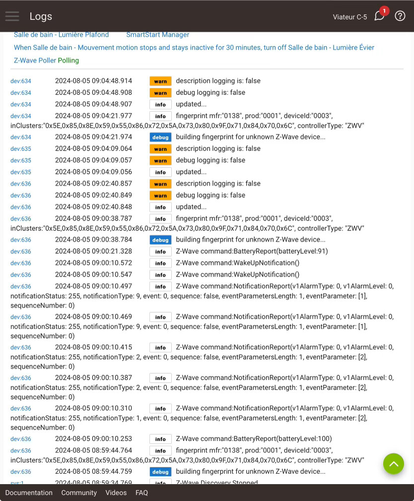

I just setup 3 new First Alert Smoke/CO detector combos on my father’s C-5 on platform version 2.3.9.160. The Generic Z-Wave Plus driver didn’t automatically get assigned (got “Device”). Here’s the device’s fingerprint:
I use his custom drivers for my 10 First Alert smoke detectors and it works great! I highly recommend it and once installed, new additions default to that driver.
