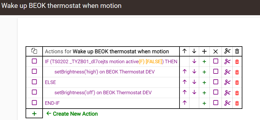

do you use this functionality together with a presence detector? So if a person is near the thermostat the display will light up? If yes, does it work well?
I was only testing this in a RM rule for few days a couple of months ago, but I will restore the configuration tonight.
After I switched over mmWave radars for lightning control in all rooms, I have now a plenty of cheap PIR sensors left to experiment with … : )
do you already have some experience to share concerning the display lighting up in combination with your mmWave radars?
I am using a rule like this :
I am using an ordinary PIR motion sensor here, the keep time is 30 seconds.
EDIT: and unfortunately, the RM commands fail sometimes.. : (
Is the rule failing or the command on the device?
The command is ignored by the device sometimes - same like the on/off failures. But here we have a very simple single command to control the brightness!
is it not an option to use the same "fix"?
