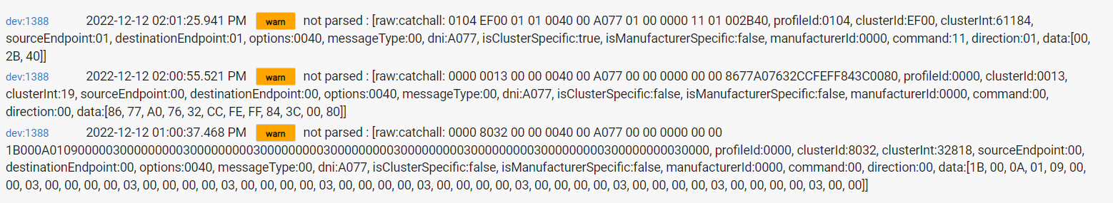

@kkossev,
Could you please advise regarding the warning below?
Summary
Hi @iEnam , these warnings are nothing to worry about, just unknown or not important system messages received from the TRV. In the next update, I will change the logs type to 'debug'.

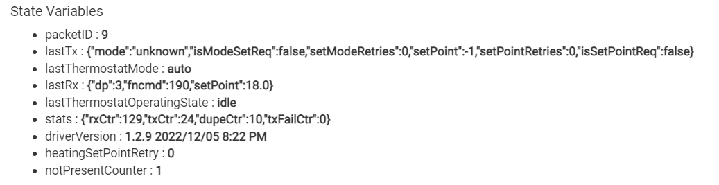

What is the application version of your new device?
Mine is 48 :
  • endpointId: 01
  • application: 48
  • lastRunningMode: heat
  • manufacturer: _TZE200_ye5jkfsb
  • model: TS0601
Same
