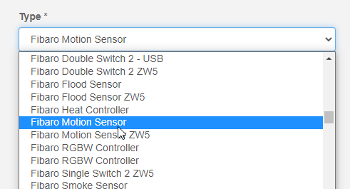

Add the sensors to ST using the integrated Fibaro Motion Sensor device handler (not the ZW5).
Use HubConnect 2.0 RC2 with Dome Motion Sensor driver.

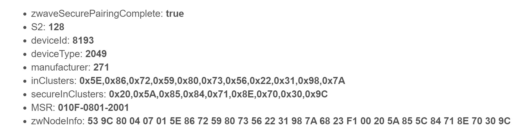

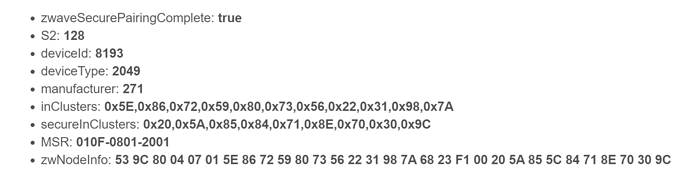

On the C-7 did it join secure? Past the Data section form the bottom of the device please
Yes here the data.
Okay. I had issues with these things joining as secure S2.
They just didn't work batteries drained, unreliable.
