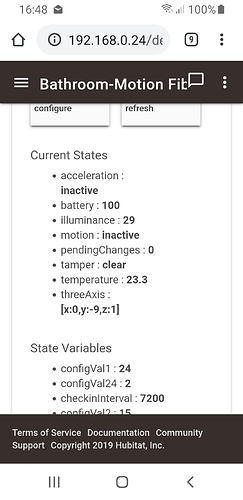

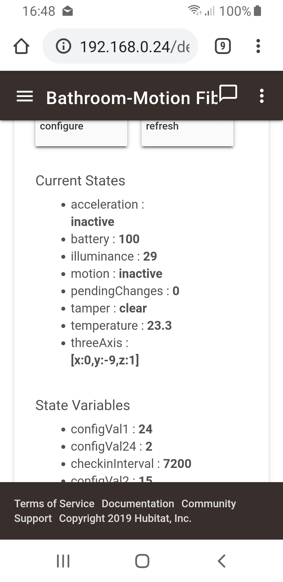

I'm using the built in Fibaro Motion ZW5.
Motion is working ok.

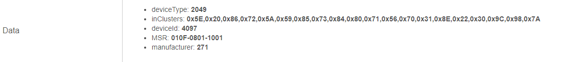

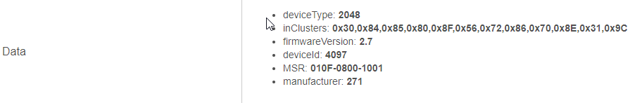

Working devices on the Default HE driver which are working as expected:

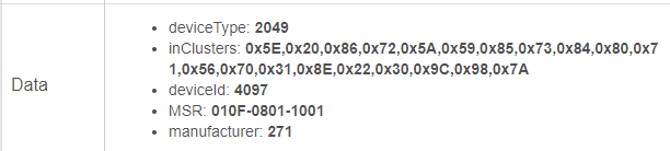

The new motion sensors I have recently bought:

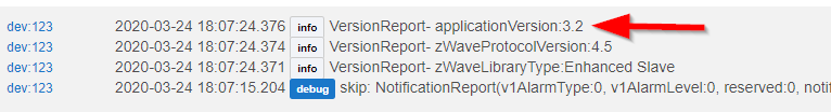

Does anyone know the best way to update the firmware on these devices? I see there is work being done on another thread but doesn't look like HE supports OTA updates for ZWave yet...
After thought: I wonder if I can update on ST and then bring them back into HE...hmmmm...tonights plan :slight_smile:
I think 2.6 are z-wave where 3.67 is z-wave plus.
I'm not sure you can update the firmware to change them from z-wave to z-wave plus.

What are you seeing in the Data section for each type of sensor.
I'm just trying to work out what version mine are then maybe have a play.
Yes, this is basically correct.
Up to 2.8 is z-wave. And 3.2 and higher are z-wave plus.
This is from my 2.6 version:
Only motion is really working. Like you I also want Lux to report.
This is from my 3.2 version:
From the info you have just given me I have 2 devicetype 2048 and I have 3 devicetype 2049.

Update: Oh, so you do have both types too....interesting...
What is also interesting is that your earlier sensors are showing the firmware version under data.
Mine do not show the firmware version for both types.
Do you think that could have been added to the "metadata" by the Basic ZWave Tool? But having said that, I did it with my other sensors and they don't have it displaying. There goes that theory :slight_smile:

Your 2.6 version is zwave+. It has incluster 0x5E. You should check if it can be upgraded to 3.2
Sorry - that was your 3.2 version. My mistake.

But, since you have the old version as well, do you get temperature readings ? And what is the refresh time?
I've managed to change the parameters from the native driver, it works for led color for ex, but i'm not getting any temperature updates. What values do you use? 60. Temperature report - threshold, 62. Temperature measuring - interval, 64. Temperature report - interval.
