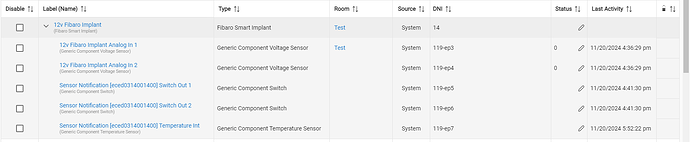

I have Fibaro Implant on Z-Wave but the voltage doesn't show on device info yet the voltage is in the log with debug on?
Not sure what I am setting up incorrectly or missing some custom code to accomplish.

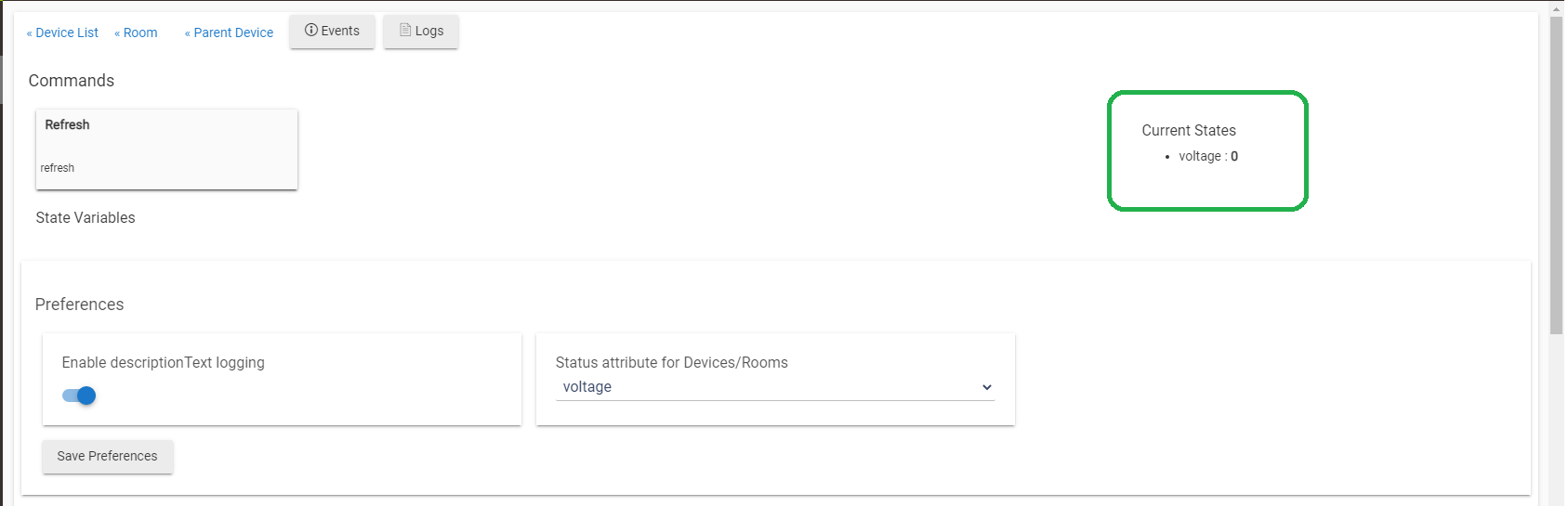

On the child info page it doesn't show the voltage

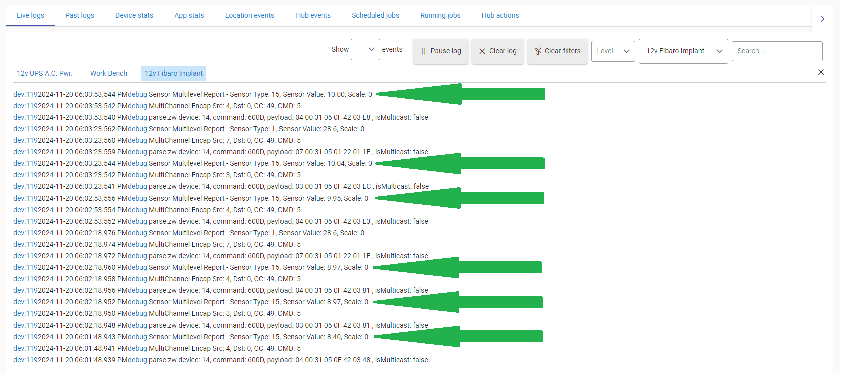

But in the log I highlighted where it does show the voltage
I noticed that in the log next to voltage there is "scale" which is zero, my guess is I need to set to 1 but have no idea how to. Or it is something else completely and I have zero coding skills so far with HE

Tried attribute, the issue is the device info child shows 0 volts and therefore so does the attribute.
Only in the log I see the voltage from my test power source connected to implant.

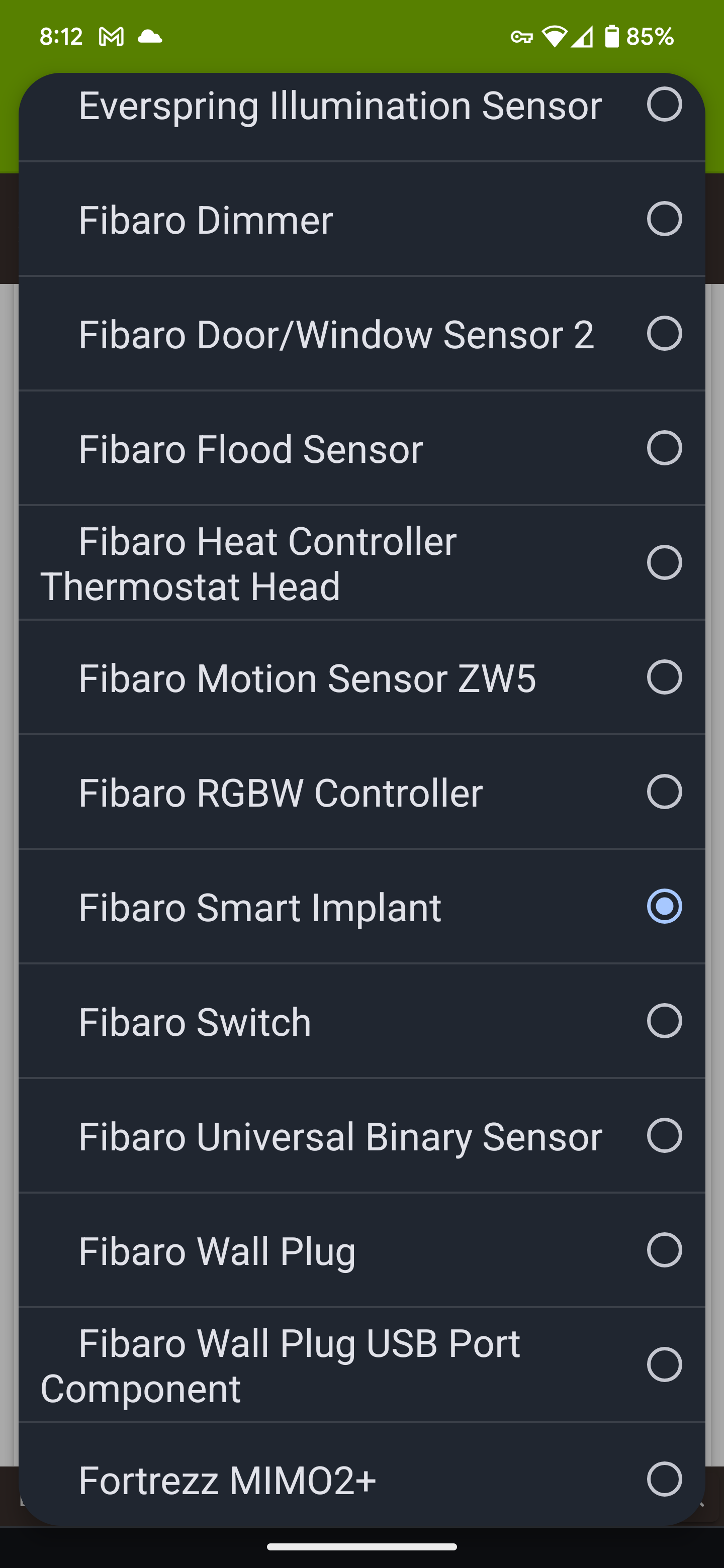

Once the HPM has copied the files from Github to your Hub, you can go to the Implant's device page and change it's "type" to "Fibaro FGBS-222 Smart Implant" (in the User section of the list, towards the end...), "Save Device", etc. The instructions are in my drivers thread.

Device type still shows original type

Edit: in mobile app I could not find user files, on PC it was found when setting up...
Device type will not change until you change it, scroll down to the user section of that list and select the new driver, then press "save"
