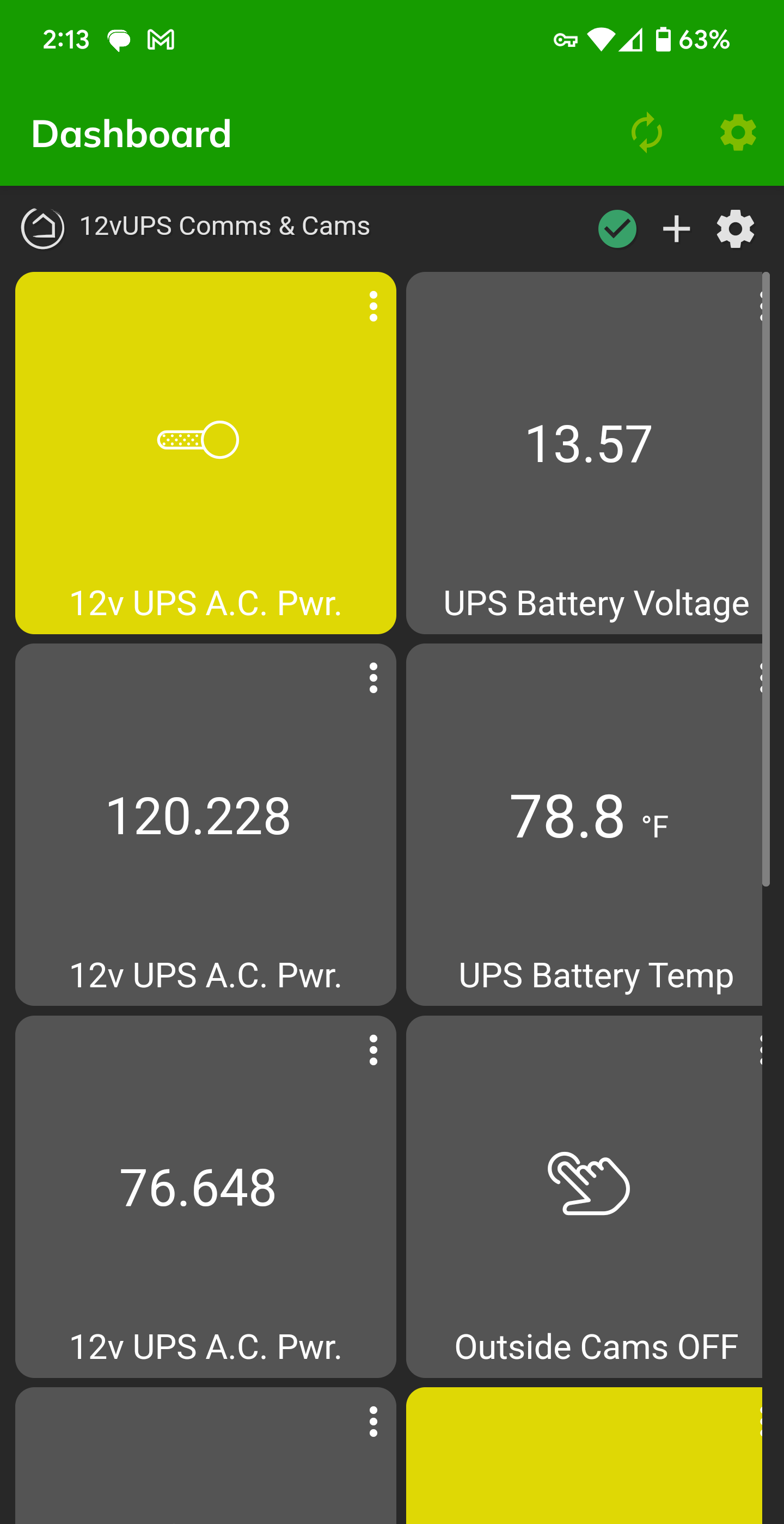

Nah, I don't want to mess it up....
It's rated for 10 and testing the highest I went was 15 volts.
It's already installed on my 12v UPS system now and will never see more than 14.2 volts if on fast charge or usually 13.6 float most the time.
My bench supply only goes to 18 volts anyways...
I have it so during a power outage I can keep track of battery level and start generator as needed to recharge. 11.9 is where Low Voltage Disconnect from battery happens.
Currently doing a battery runtime to low voltage disconnect test to see how long the usable 120 Ah goes. 2x100Ah 12v AGM batteries
Fibaro should update their specifications, they would sell more of them
I was reluctant to buy one because of the 0-10 v spec, but rolled the dice anyway :grin: Glad I did
