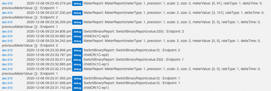

So its working now and I thought I would turn on the Debug messages and see if I can learn more about zwave commands and Hubitat Device Handlers.
I am seeing the following messages in the log when I turn off and on each of the 2 endpoints.
Should I investigate these further ?
What comment/log are you concerned about? Everything looks good to me.
