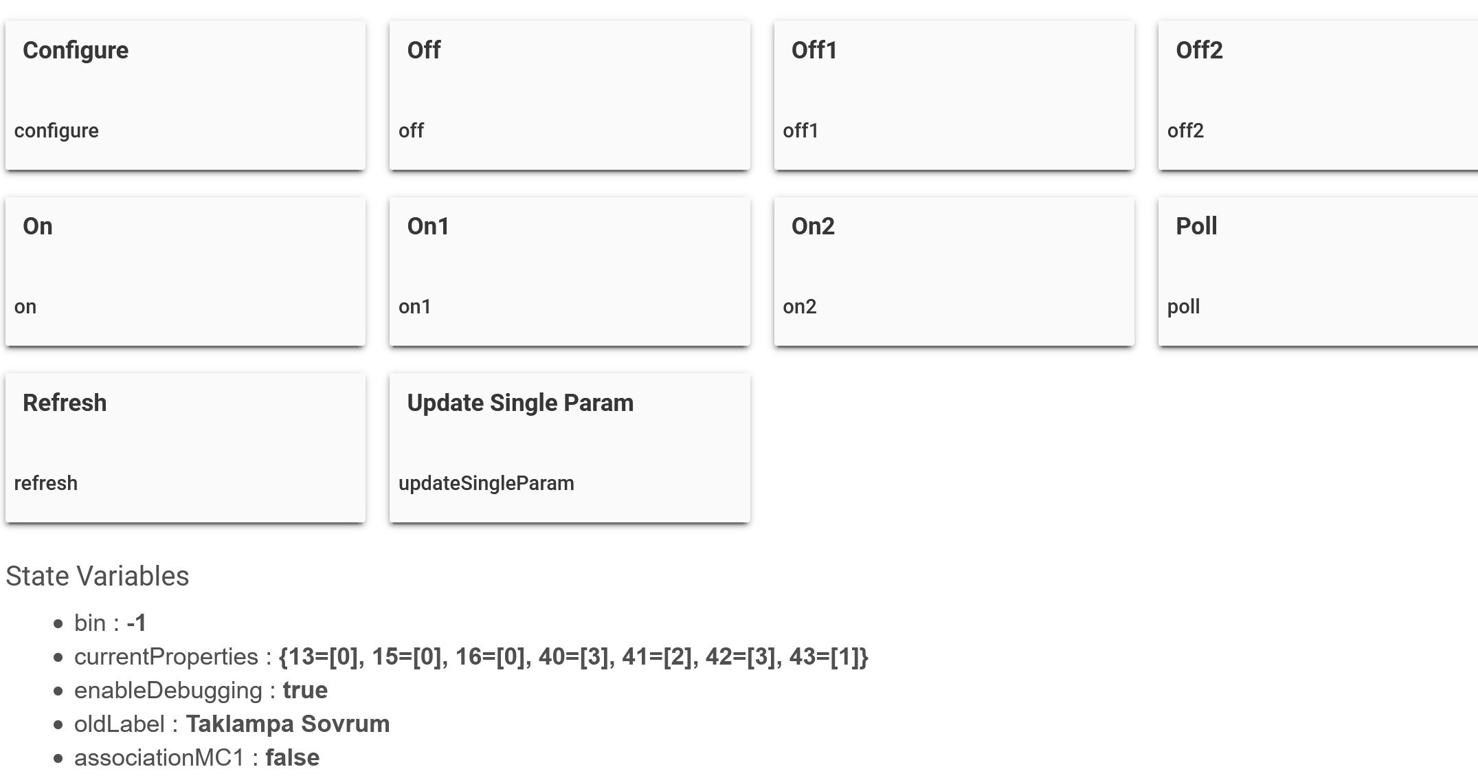

Hi All,
Does anyone have the device code for a fibaro dual switch (note relay).
I've tried the relay switch driver and this doesnt work.
The Fibari single switch driver works but only operates (not surpisingly) one of the two switches its connected to
Cheers,
D
Is this the one you are referring to?
This driver doesnโ€™t work, but I believe itโ€™s because itโ€™s for the relay version rather than the switch version(I have a mix of different types)
Cheers
I'm still unsure what switch you have.
If its the 222 then you use this to create the 2 switches.

So I have got my FGS-223's working using the Dual Relay Driver.
But I notice that the driver is generating a load of messages in the Log. Is this an issue to be concerned about as the switches are working all ok
If no error(red) on the logs then it's ok, probably you can turn off the logs but if no option to turn off it's ok too, some ported drivers doesn't have the option.
Hello,
I have the same problem. I am new to Hubitat, I've been a Vera user since the beginning and this a whole different approach for me.
Anyways, I have a Fibaro FGS-222 which is found correctly, I since then installed following drivers:
222 driver, metered service, the virtual device sync app and simulated switch.
The virtual device sync creates 2 child nodes which I can control. The physical switch is momentary (has a spring) and my problem is: No matter if I press the physical button or the button on the webbpage ON will light upp the lamp right away, however, OFF will have a delay of c:a 10 seconds.
Hope somebody can help, I happen to have quite a few of these FGS-222.
