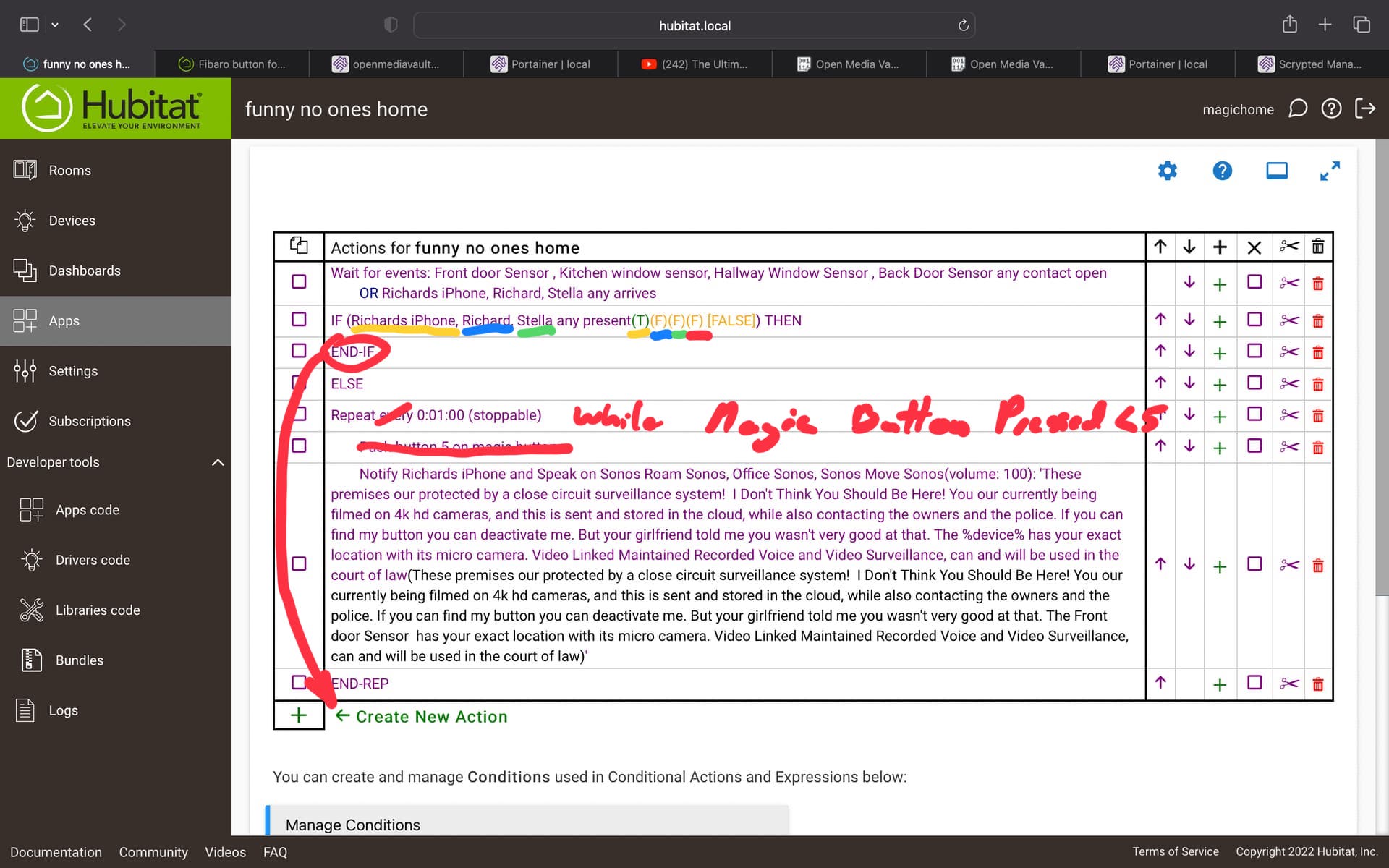

Yea, there are changes required to the rule for it to work:
is this any better?
the push Button 5 on magic command is me trying to say push the button 5 times to end the automation but I can't work out how to do it right lol
Here is a visual of the remaining changes:
Note that there seems to be an issue with the If condition. There are apparently 3 conditions to check, but 4 “(F)”, this probably means that there is an “empty” condition and therefore the condition will always detect this as false.
The easiest to do here is likely to remove it and add another that says “if (Richard iPhone, Richard, Stella all absent) THEN”. If you do this, the “ELSE” can be removed.
