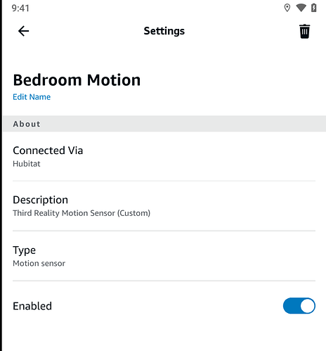

THE WANT - In an Alexa device - the description should NOT want the device driver name, it should have the device NAME!
My argument is since in Alexa the Alexa Name prefills with the hubitat Label (and I totally disagree with this too) if you edit the name and call it something completely crazy, you lose the ability to see what the true device is on the HE side. EG; I share an HE device “labeled” Bedroom Third Reality Motion Sensor. Alexa discovers automagically and I have a new Alexa device “named” Bedroom Third Reality Motion Sensor'. Then in Alexa I rename it to ‘Human here’. Now, when I look at the Alexa device I can now longer remember what the connected HE device was/is and there is no way to know which HE device I’m referencing. Since Alexa doesn’t expose the Alexa device ID, it degrades over time as devices get renamed and I can no longer tell which ‘Human here’ device in different rooms I’m seeing.
I recognize legacy is a PITA. A change at this structural level MIGHT break stuff (I think this would NOT break anything). But that is my want - push the HE device NAME to the Alexa device Description - there is ZERO need for the driver associated - it’s unnecessary data on the Alexa side and an oversight / legacy from before there was a Label in HE.

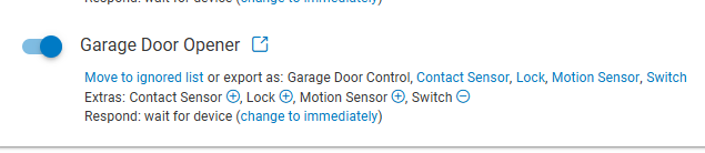

But you can pick a capability, not in the driver, but in the Alexa app. Simply uncheck the things you don't want to send to Alexa...
Just hit the :plus: or :minus: next to the attribute you don't want to share. It would be atypical to want to share most of these extras like anyway, you are nearly always looking for one attribute like motion or a switch/dimmer.
In my example image below, I can just share the garage opener, and ignore the built-in light, built-in motion, or other cruft.
Thanks for responding @neonturbo . So I learn something today - I never looked at the ability to enable / disable specific capabilities (you called them attributes, which I think is incorrect). And as educational as that is, it is useless to me in general.

However. My topic is really about what ELSE HE is sending over at the time of the bridging. The device description is filled with the driver. If you have 15 Third Reality Motion sensors (as I do) then I get 15 things on the Amazon side that all say ‘Third Reality Motion Sensor (custom)’ which is the name of my driver. My want is to put the device NAME information there. When I connect a new device on my HE and send it into the Echo Skill - it gets picked up on the Alexa side - and the Alexa WRONGLY gets the HE device Label and uses that for the Alexa Name. As wrong as that is to me, I’ll pretend it’s okay for now. but Why send the Driver name? its 100% useless. At least fill the HE Name in there so I have some hope of finding the device if I botch the Alexa name field.

Is the problem you’re trying to solve that information about a device is getting out of sync between Alexa and HE? On the Alexa side, the name field is user-editable but the description field is not, so you are looking to change the HE source for the Alexa description field so that you can use that to cross-reference your list of Alexa devices with your list of HE devices. Do I have this right?
Keep in mind however that both name and label are user-editable on the HE side, so the correspondance could still break, unless HE-side changes get synchronized back to Alexa, say, by re-discovering them through the Hubitat skill? I am not sure how this works, tbh.
EDIT: I ran a quick test and confirmed that:
  • HE-side device label changes don’t come across to Alexa’s device name if the device name was changed in Alexa i.e. renaming the device in Alexa is sticky
  • It’s currently the device driver name that populates the Alexa device description field
  • Changing the device driver and re-discovering devices does update the Alexa device description field for the linked device.
So I agree with you that the Alexa description field would be much more useful if it was set to something other than the device driver name. It could be set to either the HE device label or name (you asked for the name, I think the label would make sense, but not a big deal), allowing the user to customize the Alexa-side device name to be different from the description, if they want to.
