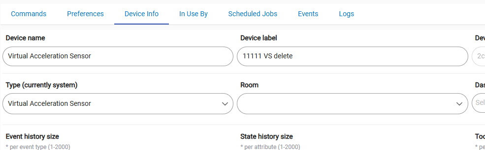

Edit: forgot to add a screenshot of a new device I created. Notice the Device Name and how it matches the Type, and the Label is some nonsense I named it upon creation.

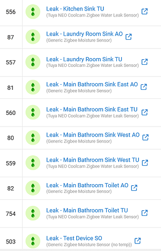

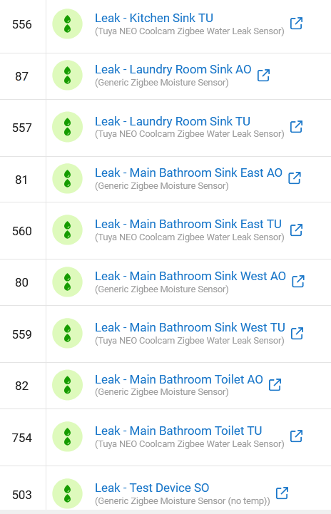

There is definitely a place for long Device Labels – I want the Devices page to sort by device category, location, and device manufacturer/designer code (e.g., TU = Tuya)
I would argue that you don't even need the suffix like TU, Tuya is in the grey line right below each name. You could modify the Generic sensor to have the Mfg. similar to the Tuya.
How does that TU affect Alexa and other things? Does she say "water found in the bathroom too (TU)
… does not show up in device lists when writing rules and several other contexts.

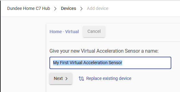

I create a device. I call that device ‘My First Virtual Acceleration Sensor’. Look closely at the screen cap. It clearly says ‘Give your … a NAME’.

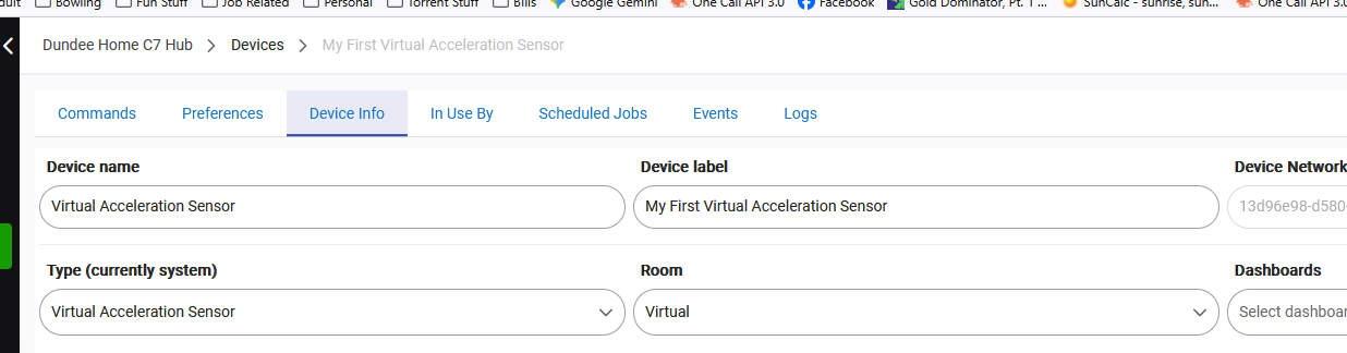

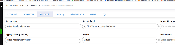

I stick it in a room, the select view device details - then select Device Info tab in the device. Where is my Name? it is in the LABEL field !!!
Now, if you give me the benefit of the doubt, when I first assembled THIS house 2 years ago I built from scratch - even tho this is my 3rd house in 5 years I’ve built out with HE. I started OFF wrong and never looked back. Regardless of whether you care how I could be so stupid - the fact remains, there is a clear issue here that we ALL should have seen before.

I agree that the terms "name" and "label" are poorly and inconsistently used. It has definitely confused me in the past (still does, but I've just learned to live with it). We commonly use "name" to identify people and places, not "label". The inclusion process says "name". So, the whole thing is confusing.
The system cannot be changed as it would break everything. However, I also agree that the inclusion screen could simply be changed to say "Give your ... a label:" and that would go a long way.
