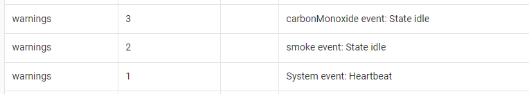

This will be sent to an attribute you can use for a rule. The number just increases each time with a reset command to set it back to 0. Example below is normal events for testing, normally those wont go to a warning but all the other ones I listed up above would.

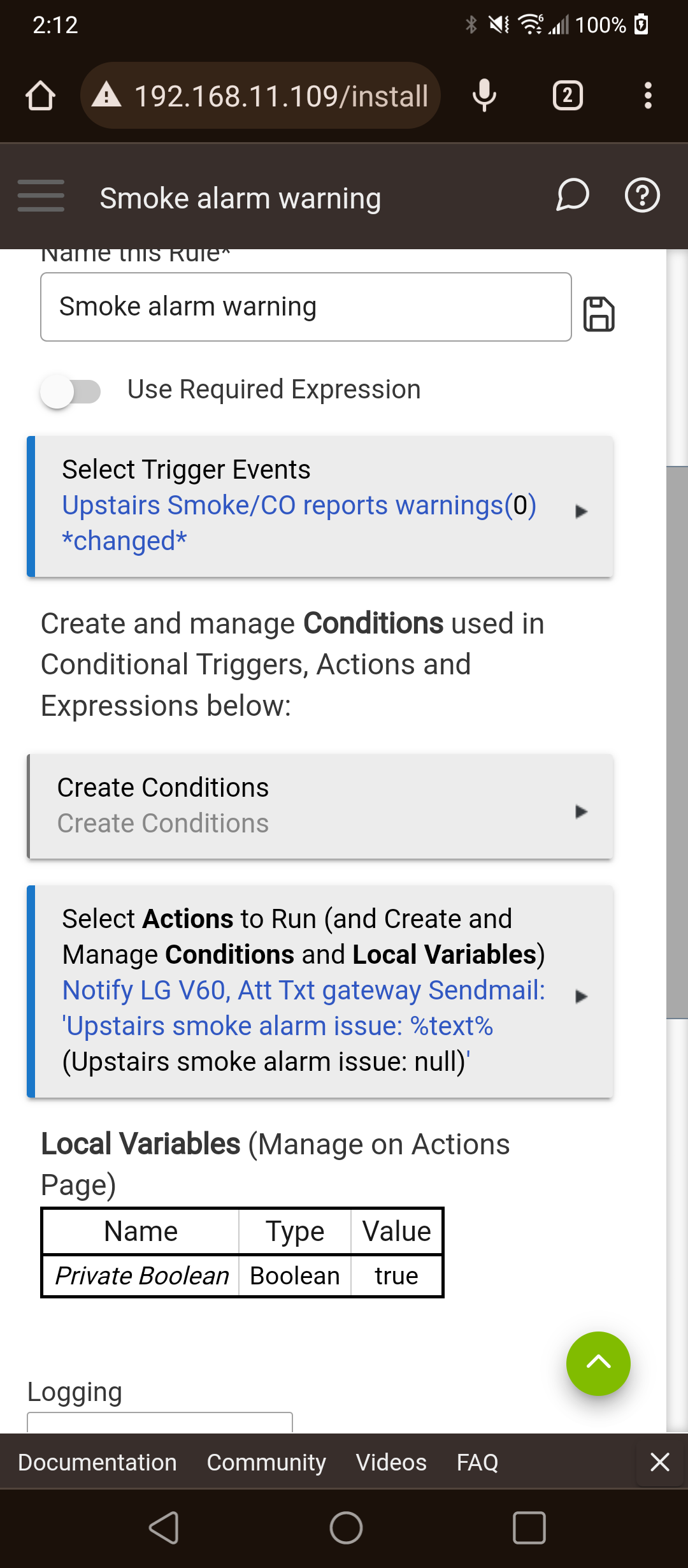

Thanks what events would i check for
Any change to the attribute “warnings”. The %text% value contains the translated alert message.
Thanks couldnt set a rule as it didnt exist. Had to click resetwarnings first.
You might be able to test that by resetting it. I am deleting the state then setting it again so it might trigger the rule.
Yes test worked. Ok to leave it set to 0 anyway.
