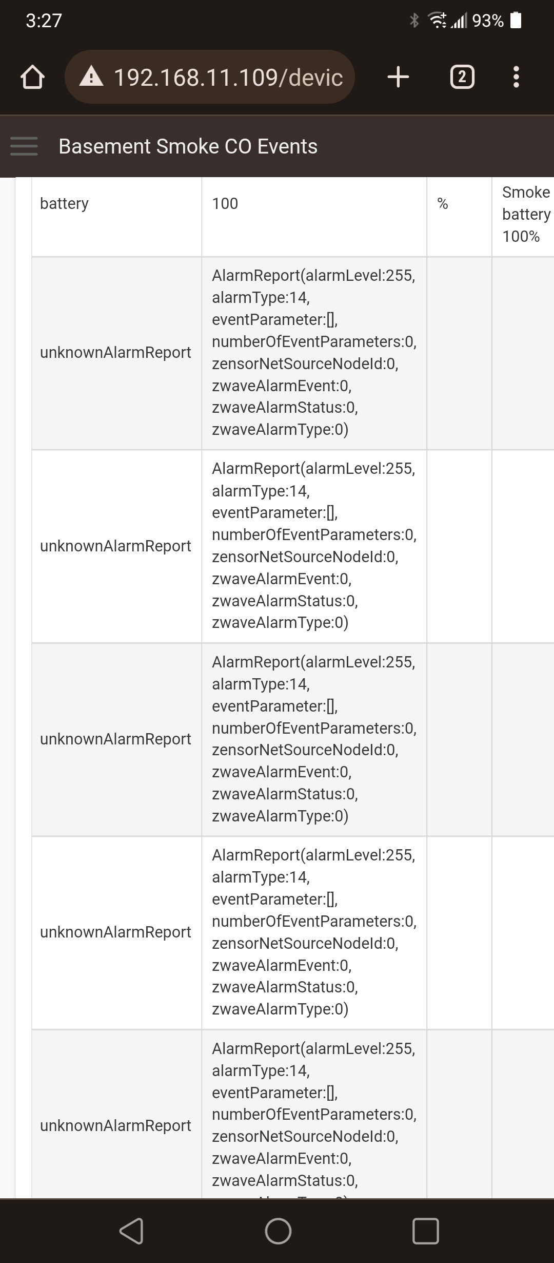

can this event be added to show end-of-life in the events and be checked for in rules.. just had my 2nd set of smoke detectors bo eol.. i think there ther 4 quick beeps .. at least i remembered this code from last time. hubitat still doesnt detect it as anything but alarm type 14.

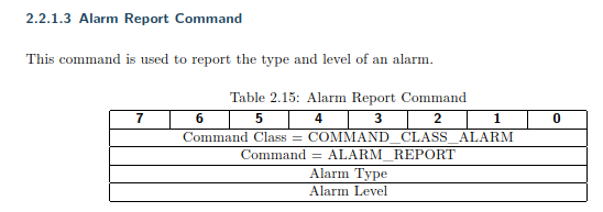

@jtp10181 : The Notification Command Class supersedes the Alarm Command Class.
[ Z-Wave Application Command Class Specification; Document No.: SDS13781]
The info I provided above was from: SDS13713 - Notification Command Class, list of assigned Notifications
Note: Since Notification and Alarm both were assigned Command Class value 0x71 [see: SDS13548 - List of defined Z-Wave Command Classes], the report comes in as "AlarmReport" even if it is from a device using the newer Notification Command class.

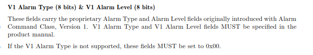

Ah yes, I was just looking at that, but the Report from the device is not a NotificationReport, it is an Alarm Report. The AlarmReport v2 added some additional fields that can reference the codes defined for the notification class but those are all blank in the posted messages. The only info being received is an Alarm Report v1 style, type 14 and level 255. Neither of those are specified by Z-Wave to have distinct meanings.

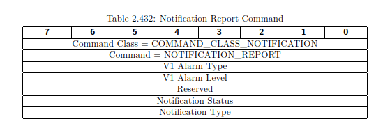

Ok so the raw command should have been
71 05 0E FF
Translated to the Notification Class
That is a Notification Report
Now if we look at the notification Class this still translates to a V1 Alarm Type and Level
So I am still convinced my assessment holds true that this message has no defined meaning in the standards.

I think you are correct... for the "V1 Alarm Type", it is up to the application to define what the type and level values mean.
