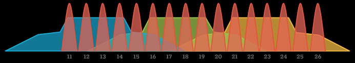

I would also make sure you're zigbee isn't overlapping your wifi..
Yeah, I've had that on my todo list for a while. The C-7 runs on 20, same as the C-5 and I haven't had any issues with that. But it shouldn't disable the radio even if I pick the worst channel.
I hope you're not running them both. The points are zigbee, the back mountains are wifi.
