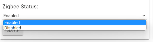

And while you're waiting...if you set the Zigbee radio to "Enabled" does it seem to come up OK and persist over reboots? Settings>Zigbee Details

Thanks @danabw -- unfortunately, although the zigbee network appears to be up immediately after rebooting the hub, it goes offline again pretty quickly.
