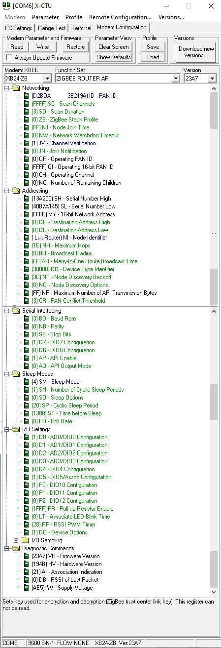

There is an extra difficulty with the old version: I do need to work configurations with an old version of XCTU, because the new one, do not recognize such old hardware (there is no firmware available for them ).
I´m attaching a picture of my XBee configs. Taking in consideration it´s old, please, if you can look for some mistaken setup I´ll appreciate.

here are the settings compared to mine
ZS = 2 (or at least 1 if no option for 2 this is likely the issue)
JN = 1
DL = FFFF
NH = FF
AR = 6
NO = 3
CR = 0
BD = 7 (115200)
AO = 1
SM = 0
SN = 130
SP = AF0
PR = FFFF

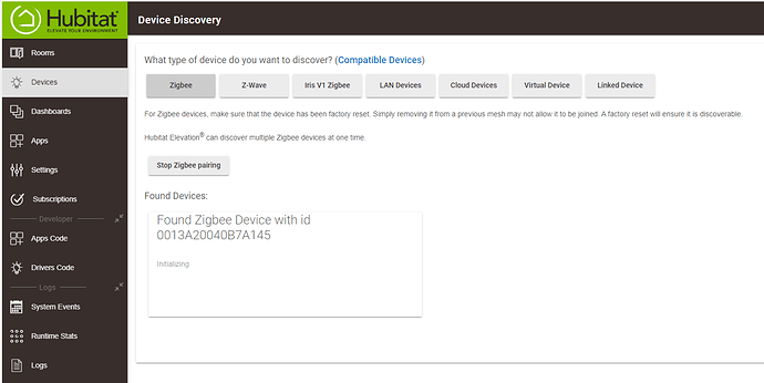

I did copy the settings you did forward me into my old Xbee, and my Hubitat hub found it!!
But it keep initializing forever.
I tried to repeat the discovering process a few times, restarted the Xbee during the "Hubitat initializing waiting" and nothing made any difference.
Do you have any suggestions ?

I did try everything. No success. The Hubitat Hub sees the Xbee, but refuses to configure it. There is no ghost connections.
I´ll rest my case. For now.
