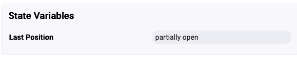

I've double checked all settings for all five shades to determine if there was something unique about this shade throwing the error, and I can't find any difference. They are all running the same driver (SmartWings Matter Shade) and every other device setting is the same. As for the odd, huge list of State Variables, here's a screen capture of what I see for the shade throwing the error...
Again, this shade, the one throwing the error, is the only shade that displays a list of State Variables like this. All other shades simply show the following for State Variables...
Screenshot 2025-07-19 at 15.53.42
