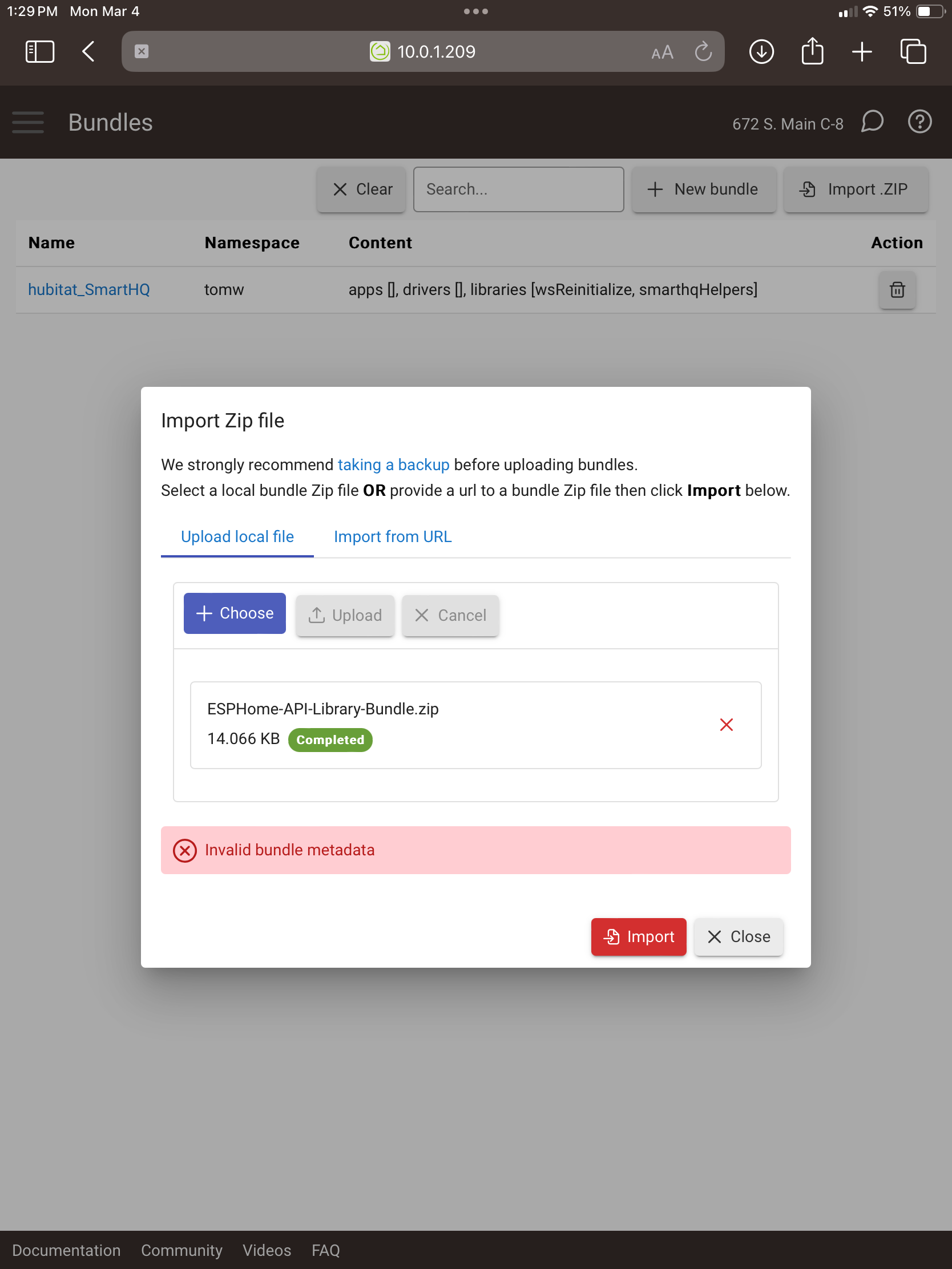

I believe that the ESPHome update yesterday has issues. HPM gives an error when trying to update or repair or even install after deleting everything. The problem seems to be that the bundle has bad metadata, as shown even if a manual update is attempted:
https://raw.githubusercontent.com/bradsjm/hubitat-drivers/main/ESPHome/ESPHome-API-Library-Bundle.zip
PR #31 this afternoon fixed things. All better now, thanks.
