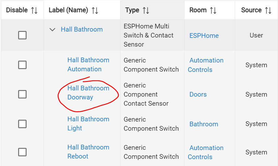

Sure, I have 10 setups running the same TOF sensor (vl53l0x) under ESPHome using this HE integration. I setup the sensor in the yaml config and link it to a binary sensor which can be read by HE as a contact sensor. Then, when the TOF is tripped (I assume your doing the beam break setup), it will close the contact sensor and then can be used in automations (Webcore is what I use).
The use case below is for a doorway sensor to toggle the relay for light switch. I also have a switch called 'Automation' that can be turned off to bypass the auto-light function. Below is the relevant yaml config statements:

Here is what the ESPHome app device in HE looks like:
