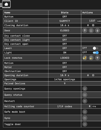

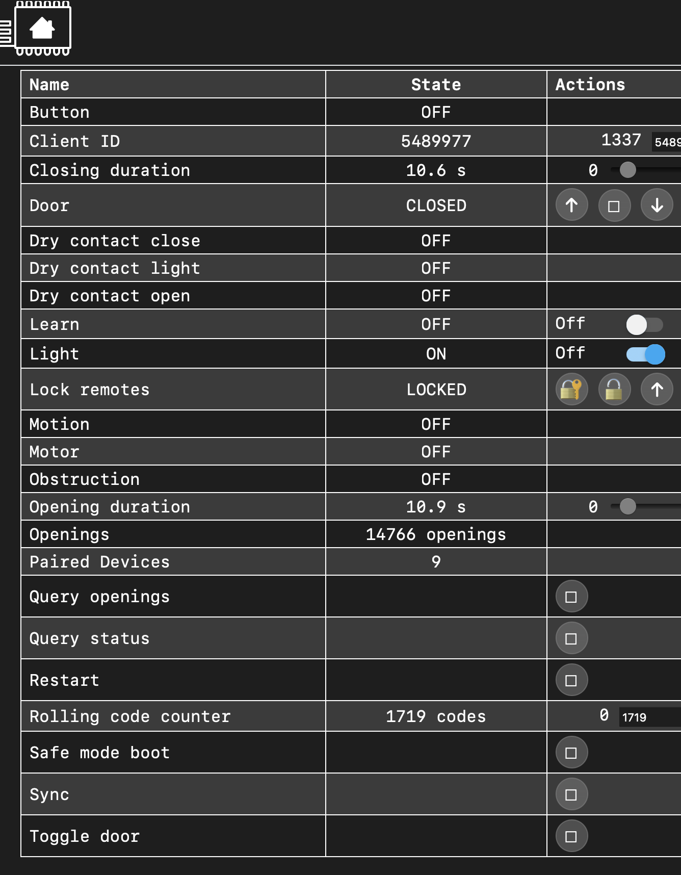

I notice in the web interface that there is also a stop button. In the device, there is a button - are those the same?
I tried the button function with 1 and also with 2, but it didn’t seem to do anything. Is there something else that this does?
are you talking about the button in the middle of open/close buttons under "Door"?
I have not noticed that button, I can look into it... :slight_smile:
Yup, that’s the one. I just tested it and it stops the door when pressed, regardless of the direction its going. Could be useful. :slight_smile:
You seem to have some options in your web interface that I don’t have - nice! (Paired Devices and Learn). More recent firmware maybe? I have 30f75c (I think…)
