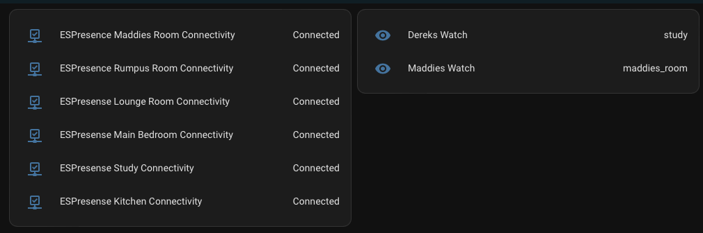

Any chance you could add direct support for ESPresence? Even if it requires an external MQTT broker, it would still make working directly with ESPresence sensors a million time easier than importing them via HABridge and then having to create RM rules to translate states (I think).
I'd be happy to help with the testing, and I have plenty of them to test against.
I don't think ESPresence is under the umbrella of ESPHome. It wouldn't make sense to include it in this driver.
I was under the impression that it uses most of the same mechanisms s ESPhome to communicate, ie MQTT and from a HA point of view, the presence sensors work roughly the same.
I believe the HA implementation of ESPresense depends entirely on MQTT, but these drivers connect directly to the ESP devices. Unfortunately, I don't think it would be trivial to recreate the mqtt_room implementation here.
That’s a shame, I’d love to shut down my HA vm.

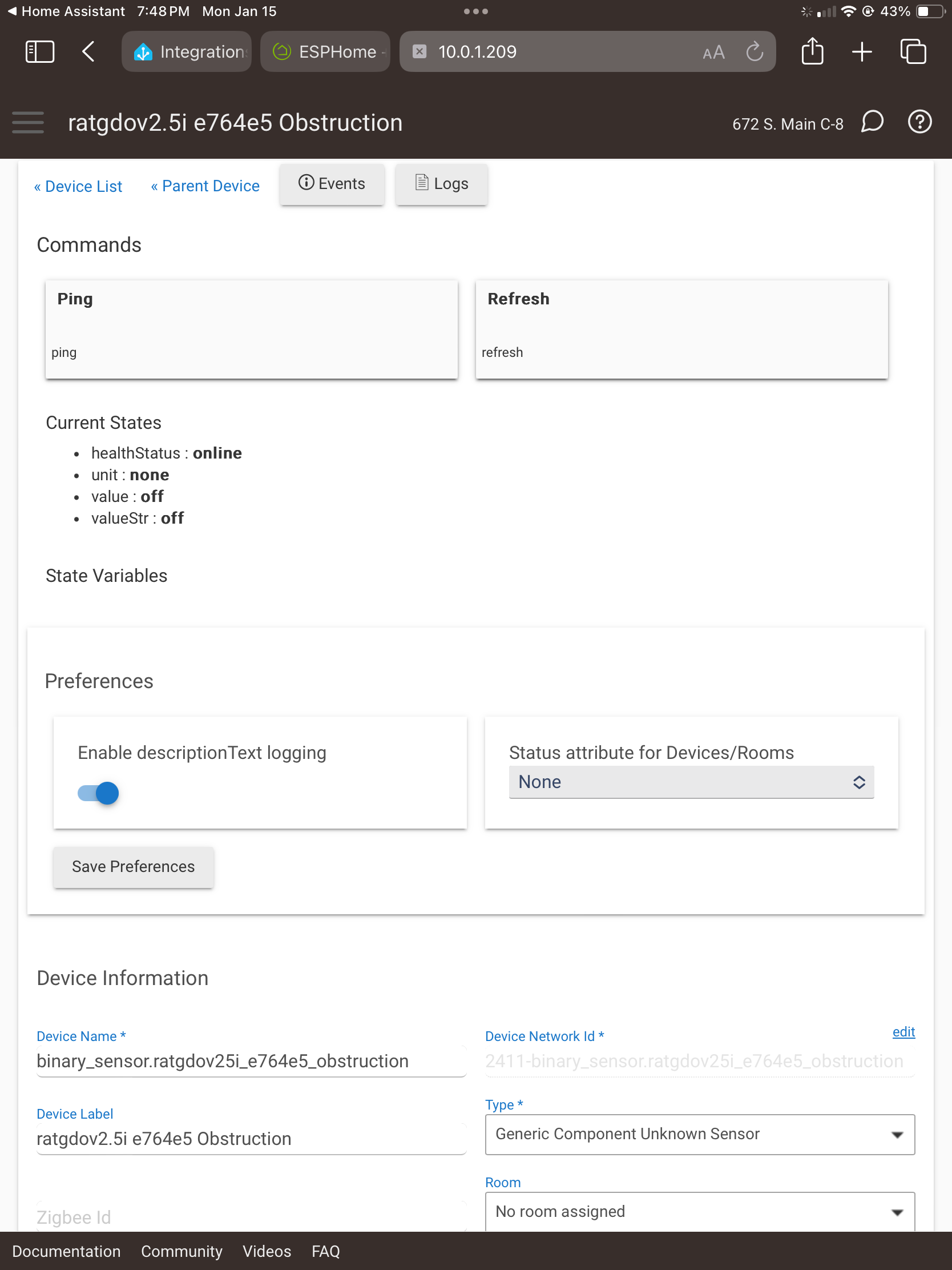

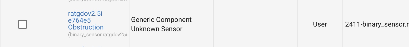

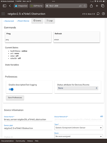

Are you able to see if there is an obstruction within Hubitat? I can see it in the RATGDO’s web interface, but not in Hubitat…
I believe so.
It’s too cold right now (8 degrees F and 6 inches snow, still coming down) to go out and test.
Lol - Indeed!!!
I think I didn’t setup my driver correctly… I set it up as ā€œESPHome Garage Doorā€ but I don’t see child devices. I’ve not had success in fixing it…
If I may ask - When you setup your device, which driver did you initially use? ESPHome Garage Door, or another one? (Should show in the Parent device’s screen).
I’ll see if I can set it up with that same driver. I suspect this is my issue, and I tried most ESPHome drivers, but didn’t pay attention for children… or wait for them to be created possibly…
I brought RatGDO into Hubitat via HADB from HA Yellow, ESP Home integration. I have also installed the ESP Home integration on Hubitat via HPM, and installed the Hubitat ESP Home Garage Door Opener (virtual device, then configured to talk to the RatGDO IP). That virtual device successfully configured. There are no child devices on the Hubitat ESP Garage Door.
So, I have two paths to the RatGDO - one that is direct through the Hubitat ESP Integration, and another through HADB to HA Yellow’s ESP Home integration.
I looked at the code for the Hubitat Garage Door driver for ESP Home, and it seems basic, has no obstruction sensor. The screenshot I showed was the RatGDO child device from HADB, which is full-featured.
