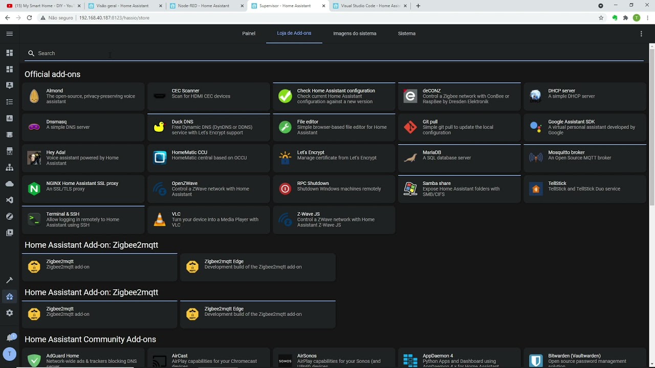

Is it possible to use the R503 fingerprint sensor with this driver?
Sensor: https://pt.aliexpress.com/item/33053655412.html
Code:
Demo video (in portuguese) - Part 1
Demo video (in portuguese) - Part 2
Thanks.

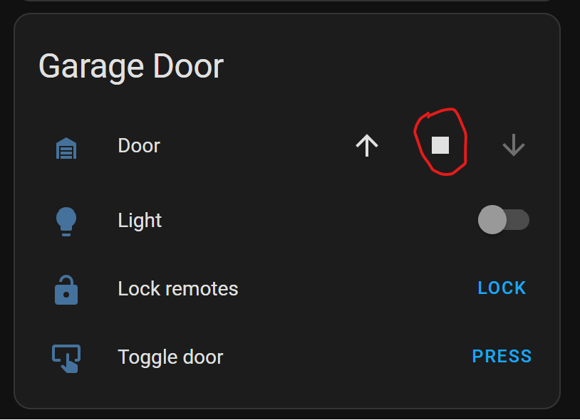

@jonathanb, Nice work on this app and driver! is there any way to add the stop function to the garage. The RATGDO you can stop the door but it does not show up on the driver on the Hubitat side. it is on the HA side as an entity. Wold also be great if it would be usable on the dashboard.

Also, the stop function is not exposed in the hubitat side
Yea, I wonder if this might not just something to add to the Hubitat driver? Hopefully, someone who knows more about driver development can chime into that one
