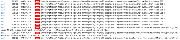

I just realized that I am getting these errors in the System driver for the aeotec dual nano driver..
further, the child devices dont update the on/off status when toggled.. I have to refresh them, and then they show the state.
dev:272025-06-19 08:10:09.619
error
groovy.lang.MissingMethodException: No signature of method: java.lang.String.call() is applicable for argument types: (java.lang.Short, java.lang.Short) values: [255, 2]
dev:272025-06-19 08:10:08.173
error
groovy.lang.MissingMethodException: No signature of method: java.lang.String.call() is applicable for argument types: (java.lang.Short, java.lang.Short) values: [0, 2]
dev:272025-06-19 08:10:04.436
error
dev:272025-06-19 08:10:02.652
error
dev:272025-06-19 07:16:49.448
error
dev:272025-06-19 07:14:30.085
error
groovy.lang.MissingMethodException: No signature of method: java.lang.String.call() is applicable for argument types: (hubitat.zwave.commands.meterv5.MeterReport, java.lang.Short) values: [MeterReport(scale: 5, rateType: 1, scale2: 0, deltaTime: 0, previousMeterValue: , meterType: 1, precision: 3, size: 1, meterValue: [103]), ...]
dev:272025-06-19 07:14:30.033
error
groovy.lang.MissingMethodException: No signature of method: java.lang.String.call() is applicable for argument types: (hubitat.zwave.commands.meterv5.MeterReport, java.lang.Short) values: [MeterReport(scale: 4, rateType: 1, scale2: 0, deltaTime: 0, previousMeterValue: , meterType: 1, precision: 1, size: 2, meterValue: [4, 214]), ...]
dev:272025-06-19 07:14:29.968
error
groovy.lang.MissingMethodException: No signature of method: java.lang.String.call() is applicable for argument types: (hubitat.zwave.commands.meterv5.MeterReport, java.lang.Short) values: [MeterReport(scale: 2, rateType: 1, scale2: 0, deltaTime: 0, previousMeterValue: , meterType: 1, precision: 3, size: 2, meterValue: [34, 193]), ...]
What hub hardware model and platform version are you running? And did you switch to Z-Wave JS or are you running default/"legacy" Z-Wave?
Platform Version : 2.4.1.177
Hardware Version: C8 Pro
Zwave JS (Non Legacy Z-Wave)

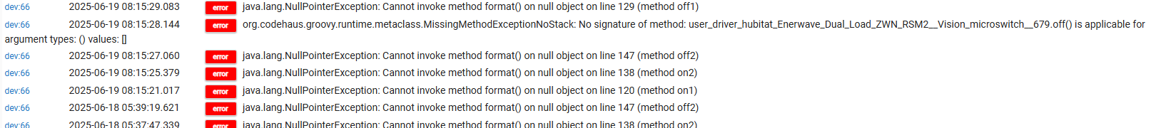

Also, found out another device also having errors .. it is a vision dual microswitch)
dev:662025-06-19 08:15:36.377
debug
Parsing desc => ‘{"cc":114,"cmd":5,"ep":0,"values":[{"request":{"args":,"command":"endpoint.invoke_cc_api","commandClass":114,"endpoint":0,"messageId":"expected43291","methodName":"get","nodeId":40},"response":{"manufacturerId":265,"productId":5911,"productType":8215}}]}’
dev:662025-06-19 08:15:29.083
error
java.lang.NullPointerException: Cannot invoke method format() on null object on line 129 (method off1)
dev:662025-06-19 08:15:28.144
error
org.codehaus.groovy.runtime.metaclass.MissingMethodExceptionNoStack: No signature of method: user_driver_hubitat_Enerwave_Dual_Load_ZWN_RSM2__Vision_microswitch__679.off() is applicable for argument types: () values:
dev:662025-06-19 08:15:27.060
error
java.lang.NullPointerException: Cannot invoke method format() on null object on line 147 (method off2)
dev:662025-06-19 08:15:25.379
error
java.lang.NullPointerException: Cannot invoke method format() on null object on line 138 (method on2)
dev:662025-06-19 08:15:21.017
error
java.lang.NullPointerException: Cannot invoke method format() on null object on line 120 (method on1)
dev:662025-06-18 05:39:19.621
error
There are some fixes for Meter Reports in 2.4.2, currently in beta, though I don't know if it will fix your exact issue. You can join now if you want or wait for release -- no timeline, as usual.
The other issue appears to involve a user driver. Maybe there's just not an off() command in the code for some reason?
