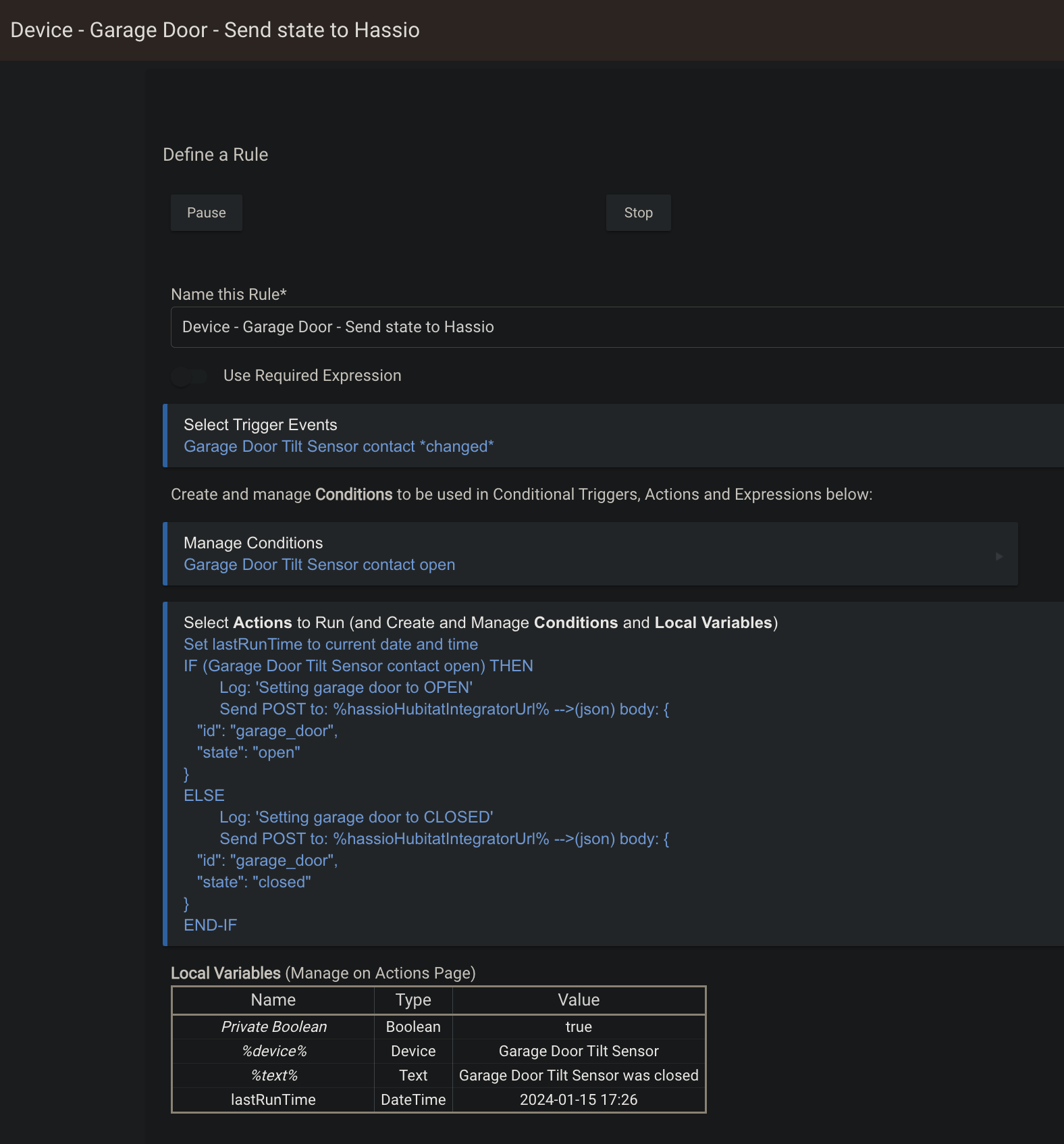

I've included a screenshot of the rule below. The hassioHubitatIntegratorUrl is defined in the hub variables, I am just not sharing it since it is a publicly accessible URL and also since the rule runs fine from the UI. This can be reproduced with any URL. I am on a C-7 hub.

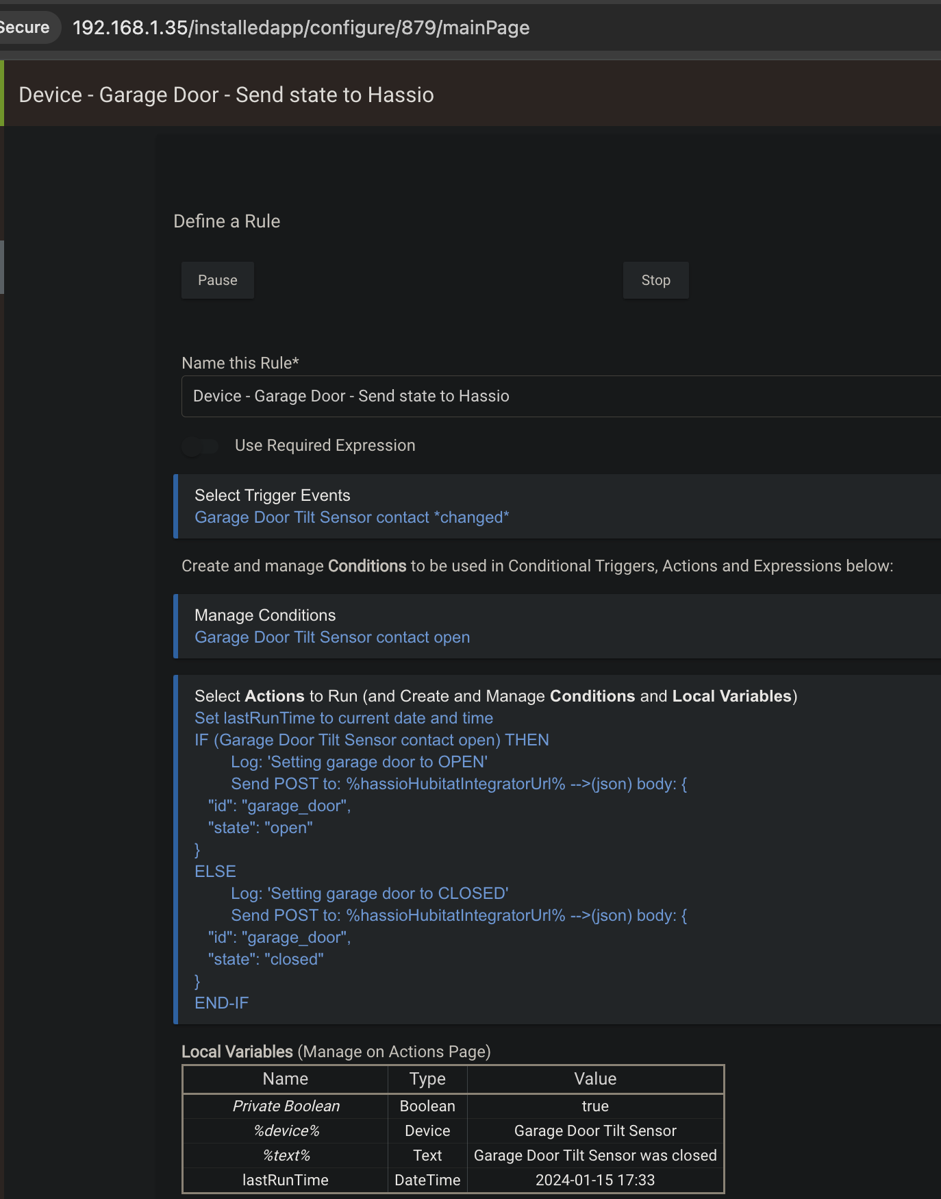

I expect it will be something to do with the Id's you have included in the URL... Are you able to confirm the RM Rule App Id from the URL in your browser when you are viewing the rule?
Sure - here are screenshots of the 2 rule IDs referenced in the original post, with the URL visible.
Rule 849 has the local endpoint that is being hit.
Rule 879 is the rule screenshot in the original post whose actions should be running.
