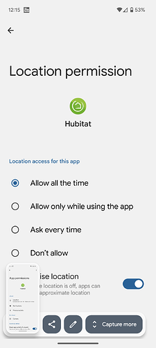

--App permission settings

This is the recommended fix.
