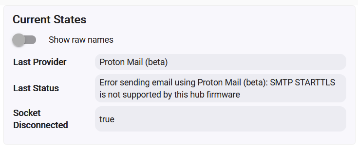

Not entirely sure how to provide feedback or show issues on this but I have been attempting to get the ProtonMail beta setup for the email notification driver. The status/error below is what I get and the log indicates the same thing (as noted below). I followed the instructions as laid out in the driver.
I’ve setup very similar configurations with Proton’s SMTP submission ability and not had issues but guessing it comes down to the hub not supporting STARTTLS.
This hub is a C-7 running 2.5.0.159.
image735×305 21.6 KB
Log message: Error sending email using Proton Mail (beta): SMTP STARTTLS is not supported by this hub firmware

It is still a beta feature, and currently STARTTLS is not supported, but we are looking to enable the feature in a future update.
I didn’t quite think of this but, i don’t think that you can run the proton integration without STARTTLS. Just FYI. So if they added it with no additional configuration that’ll probably answer my situation. :slight_smile:
Which in that case, i’m fine waiting. Just wanted to provide feedback.
