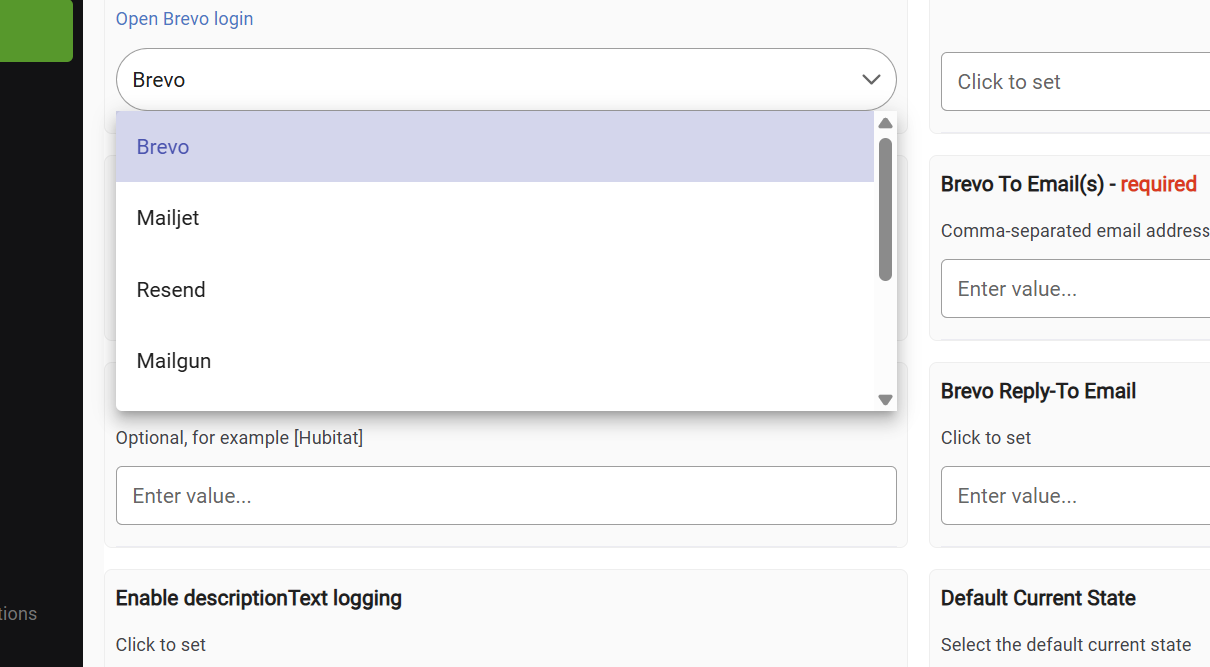

New Email Notification driver for sending email alerts!
We’re excited to introduce the new Email Notification driver for Hubitat Elevation! This driver allows users to send alert emails through several popular email delivery providers.
The driver is available now, with recently released 2.5.0.153 version.
Once configured, the driver appears as a standard notification device, allowing email alerts to work seamlessly alongside push notifications, Pushover, speech devices, and other notification methods you may already be using.
Supported Providers
The initial release includes support for:
  • Brevo
  • Mailjet
  • Resend
  • Mailgun
  • SMTP2GO
  • MailerSend
  • Postmark
  • Custom SMTP server
Brevo is selected as the default provider because it offers a generous free tier that works well for most home automation notification needs. If you already use another provider, or simply prefer a different service, you can easily switch to any of the supported options.

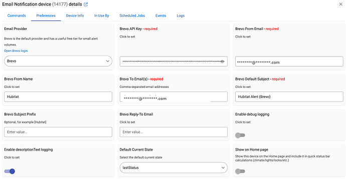

At the top of the driver settings page, you can select your preferred email provider.
Before configuring the driver, you will need to create an account with your chosen provider and obtain the required API key or credentials from that provider’s dashboard.
Once selected, the driver dynamically displays the configuration options specific to that provider. Each provider maintains its own independent settings, including:
  • Sender address
  • Recipient addresses
  • Default subject
  • Authentication credentials
This approach helps prevent accidentally reusing incorrect credentials or sender information when switching between providers.
For convenience, the driver also includes a direct login link for the selected provider, making it easy to create or manage your account.

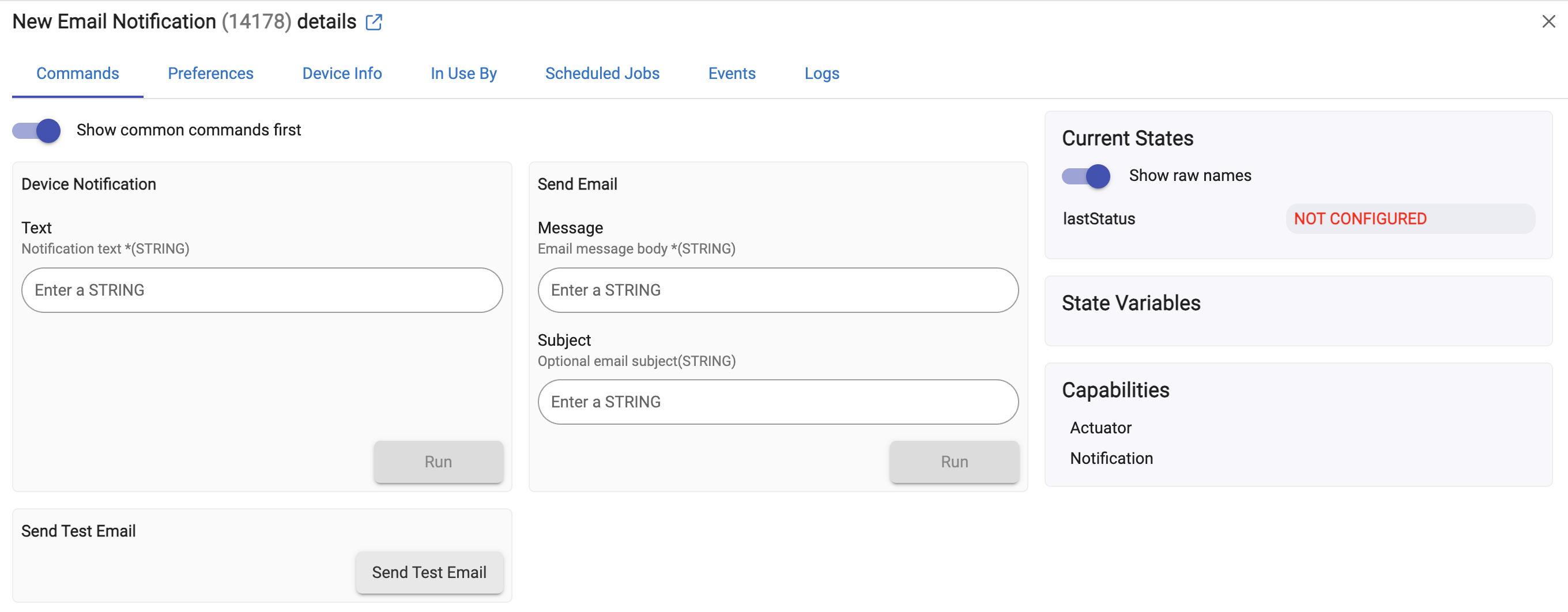

Configuration Status
Settings can be saved even if configuration is incomplete, making it easier to switch providers or complete setup gradually.
A dedicated status field indicates the current configuration state:
  • Not configured
  • Invalid configuration
  • Configured
  • Sent
If setup is incomplete or invalid, the status field will provide guidance on what still requires attention.

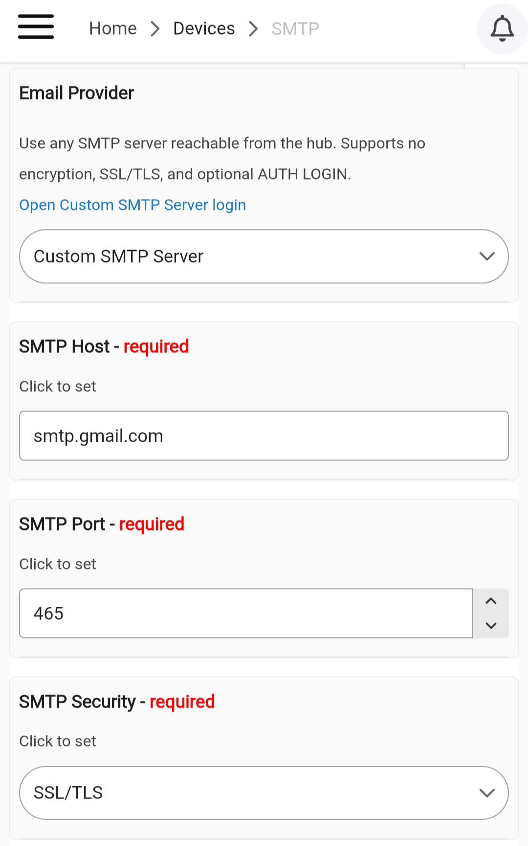

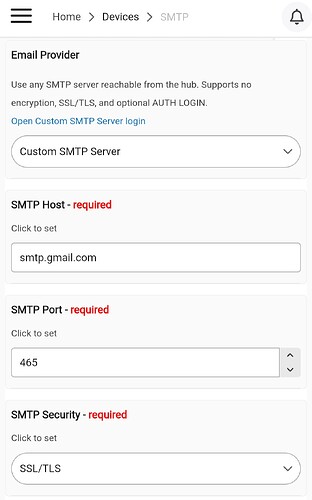

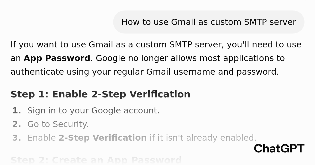

You can use a Gmail account as custom SMTP server. Follow these ChatGPT instructions:

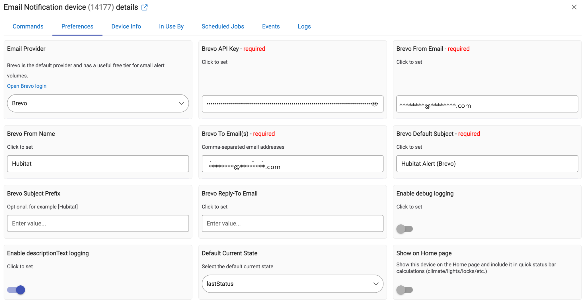

i dont see a custom option in the driver. that would be nice
here is mine .. no custom option

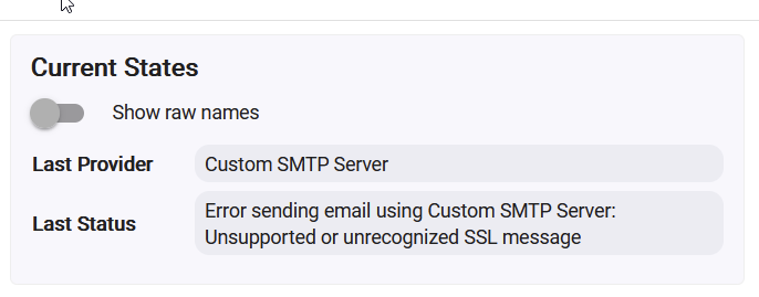

Just got this added and seeing some errors when I set it up with Proton SMTP Submission. Not sure if it’s my setup or just not supported with the driver…
It’s just Protonmail’s take on SMTP servers, much like what’s already supported. Would be fantastic if we can get this working. Regardless, nice add to the platform!

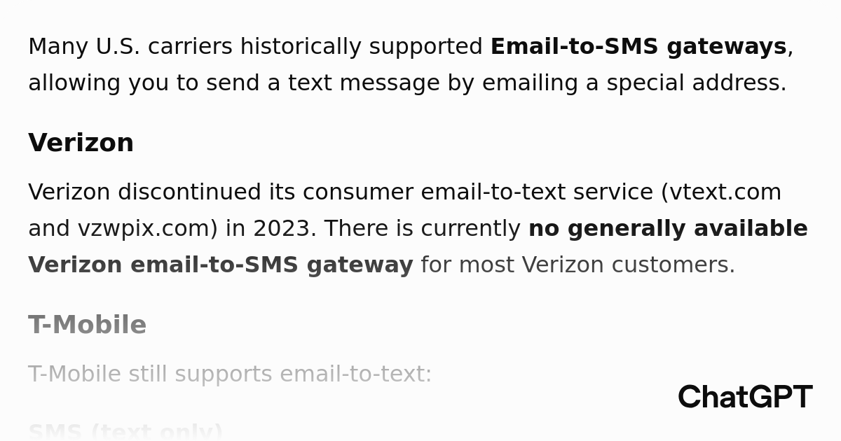

Um, perhaps “check out” the accuracy of anything that ChatGPT recommends before posting…T-Mobile let the service degrade in 2024 and discontinued email to text about 6 months ago.

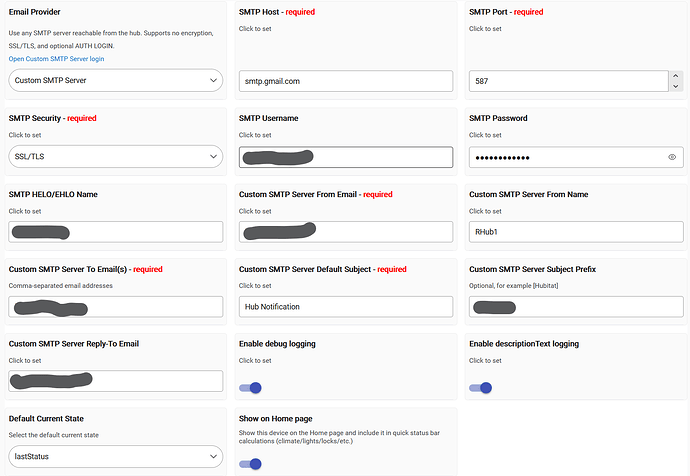

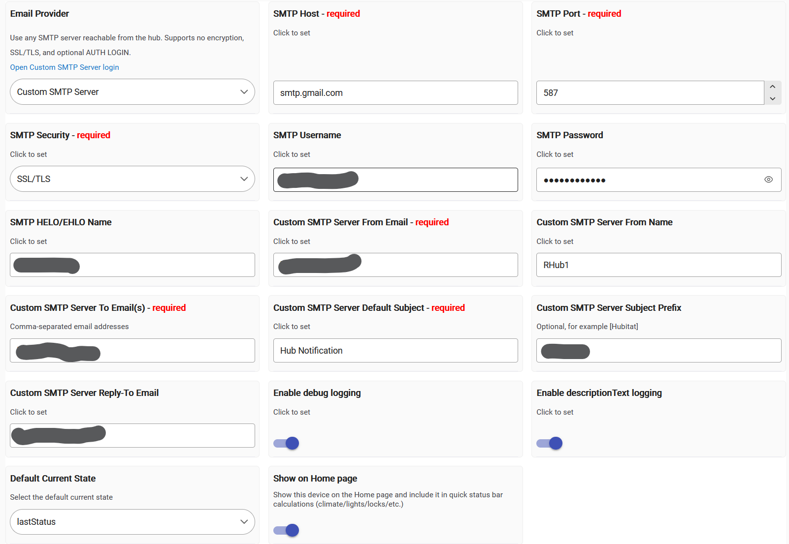

I tried to configure this for my Google Workspace domain:
Not sure what it’s unhappy about??
It's still working for me. But it's always good to test the validity of ChatGPT recommendations. :wink:
Do you have a link to the official announcement?
T-Mobile has been trying to kill the service for many years, but to my knowledge, there was no official announcement about its suspension.
To test, make sure no subject line is sent.
