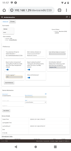

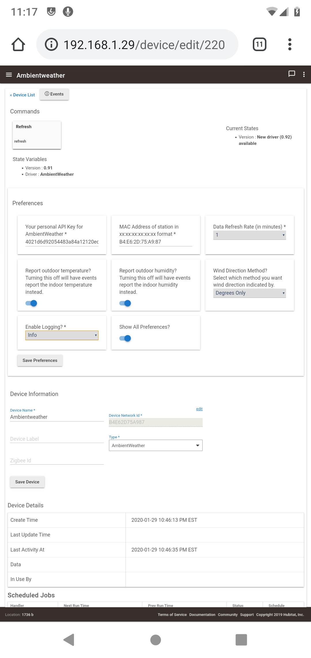

That doesn't look right to me, I see a Zigbee id (shouldn't be there), a "MAC Address of station..." (Shouldn't be there) and the "Device Network id" doesn't look like a MAC address. It is set to ed7f4ad-5aee.... It should be the gateway MAC address, maybe B4E62D75A987, exactly like that if it is correct, use the edit button to change it.
Well see what happens
It is not exactly as I indicated, remove the ":"
Ohh
Looks good if there is no space at the end...and it is the correct MAC, should work
Hmm. Idk. I'll wait but it isn't. Maybe I should reset the gw1000
Not too sure... Have to run for now
Ok, thank you. Also it says new version available under states.

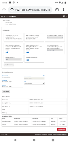

Maybe it's the version with my code in it, untested yet... You should remove the MAC address from the other fields, could cause problems, I see the refresh is scheduled because of it.

You can also check the gateway firmware version, mine says GW1000B_V1.5.6. I updated it during installation.
Hmm, it did ask me to update but now I can't recall "weather" I did. Lol but I'll check when I get back. Is there any way to remotely access it via wsview your aware of?
Nop, wsview need to be on your local network I think. Could be setup on a PC android emulator though, a bit much...
I also tested the last driver that incorporate my code, works fine, you just have to select "Ecowitt local" instead of "Ambient API" in the preferences.
