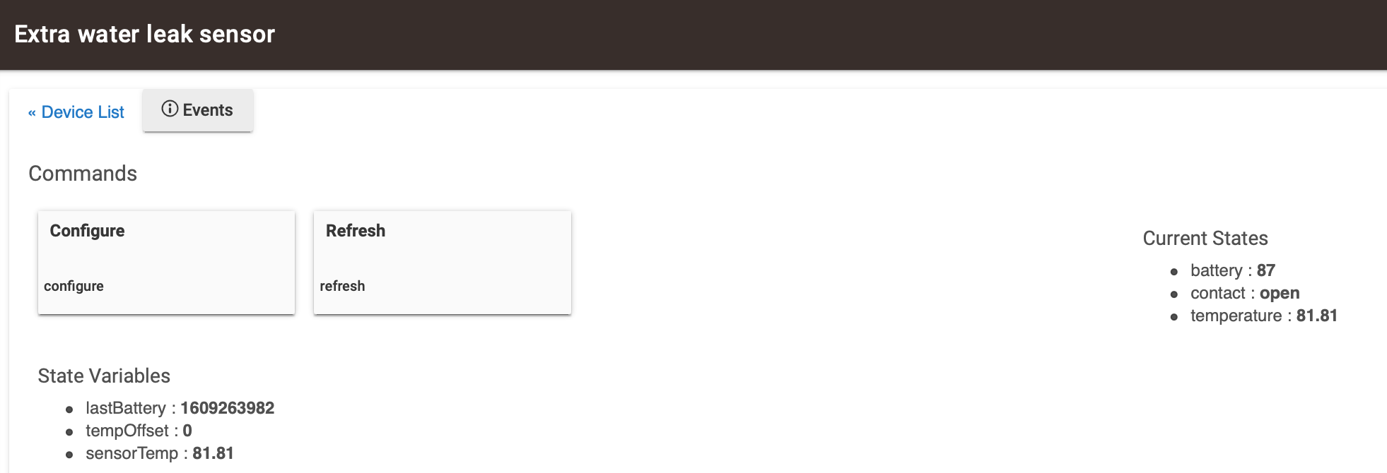

OK I am glad I am not crazy. I tried pairing it for 20 min without success and I thought "oh great. I blew it." But then I realized I was using the zwave inclusion instead of zigbee. I tried again and it came right up. It comes up as a contact sensor but I changed the driver and it works just fine.
then just to make sure I wasn't completely insane I tested it in a plate of water...
