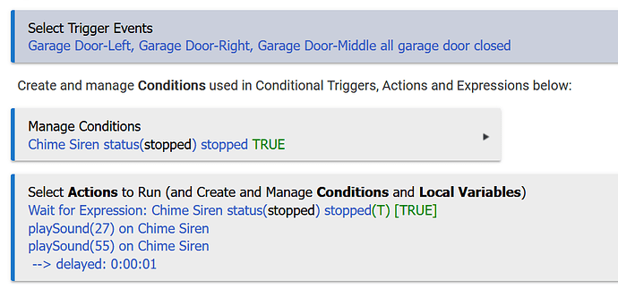

I thought I'd share a fix I did the other day that may or may not work.
I have several announcements, revolving around garage and gate actions, that can overlap. The result can be that the announcements are cut off, missing, etc.

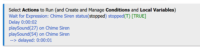

I put in a Wait for Expression condition that waits for Chime Status to be "stopped", vs "playing".
I think it works, but I haven't found a way to replicate the problem conditions-only waiting for my wife to come and go in the car. So, I'll have to wait for a few iterations of that before I can declare success.
Here is one rule. I put in a second delay after the built in, attention grabbing sound, 27, Marimba, before the custom spoken notice, 55.

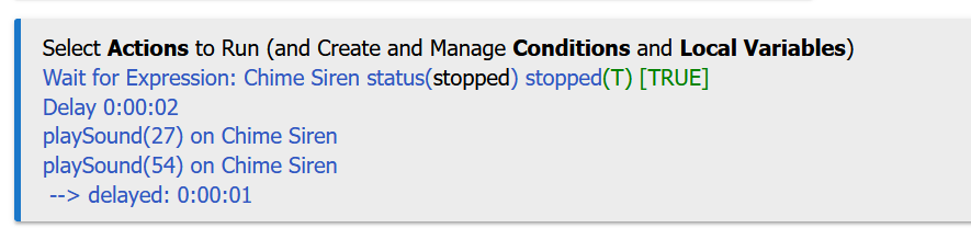

As above, but along with the Wait for Expression, I threw in another 2 second delay.
There seems to be no overlap now, based on several actual iterations.
