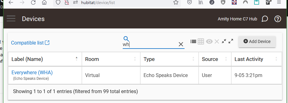

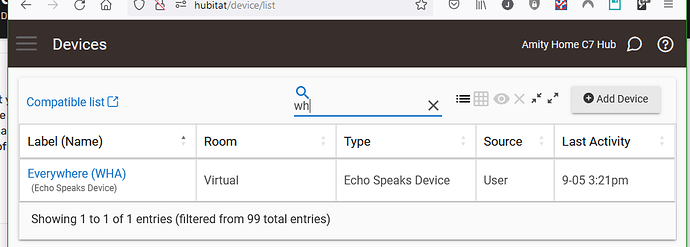

did you dabble with Whole Home? thats there 'group audio' - works well for me to send 1 message to it, and it plays on all assigned devices to that group. I haven't tweaked it in a long while - while mine still is working unsure if echo speaks is still allowing it to be generated as a device.
wha is Whole Home Audio - you go into Alexa on your web or phone, and look at groups - you can assigned specific devices to a 'group'. When one message is sent, all play. Sorta works like the 'Alexa, play music everywhere'

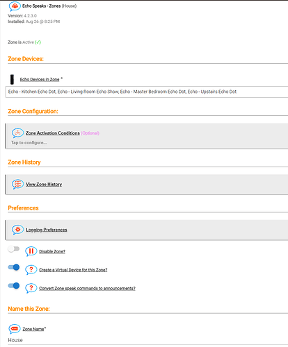

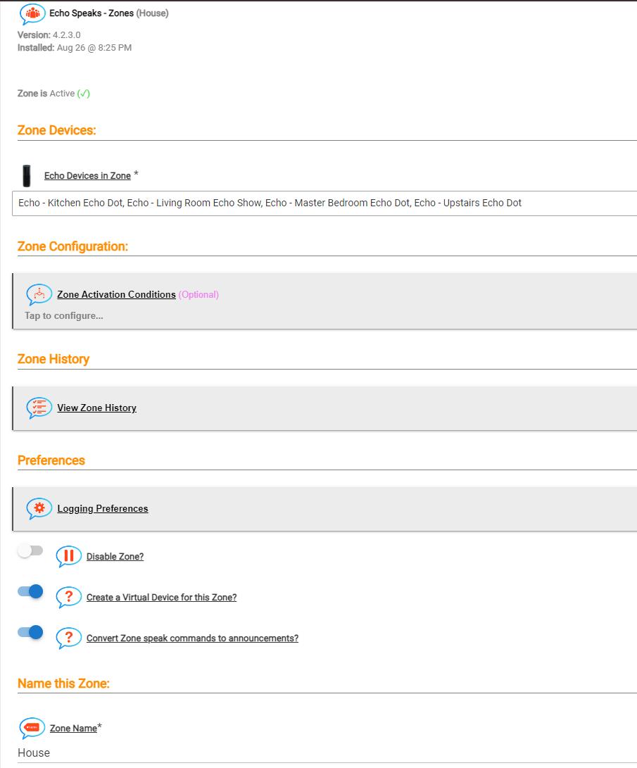

Create a zone in the Echo Speaks app itself.

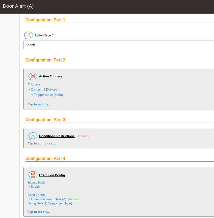

Using Echo Speaks.
Trigger: contact door opens
Action type: speak
Echo Speaks Devices: various echo devices around the house
Action type Config: default action response: %name%
I have not dabbled in WHA. This is something to look into. Thanks!

Did you create a zone in Echo Speaks? I didn't see a response to my recommendation.
Create the zone and choose the Echo devices you want to include in your announcements. Doing this will eliminate the pop-corning where devices announce one after the other.
Whoops, sorry. I did, but not like you showed in your screenshot. I will match those settings when I get time tonight. Thank you... Fingers crossed
After you create the zone and have the virtual device for it created, use that device when setting up your rules, etc. You should have all devices that you added to the zone announce at the same time when your rule/s run.
I'm unable to upload a screenshot for some reason, but when I go to "Devices", I now see my new Echo Speaks Zone Device. Do I still need to create a virtual switch off this?

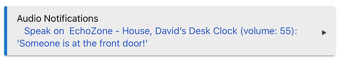

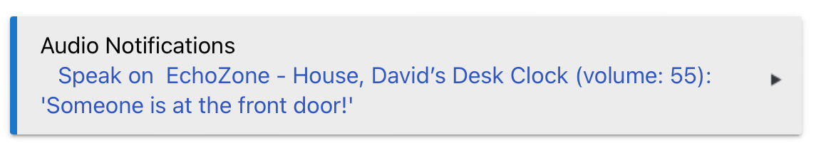

Not sure what you are trying to do. Simply use the newly created virtual device in your rule/s, notifications, etc. Look at my example below. You can see my Echo Speaks zone named House.

I see now, got it. How does this look?
I don't use Actions within Echo Speaks, so I honestly couldn't tell you.
I use Rule Machine or the Notifications app.
Well. Despite the Echo Zone, I'm still getting the popcorn effect, unfortunately. I don't get it.
