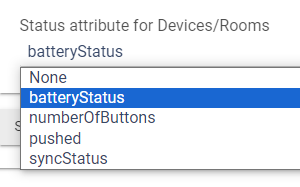

Seems like that was it. I guess it just hadn't reported a battery level yet, which I hadn't noticed. Manually woke it up and now it's there. Interestingly, my list is slightly different from yours. Not that it really matters because I'm not sure why someone would want the other attributes to show.

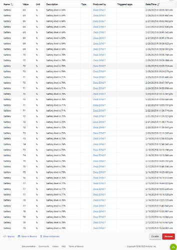

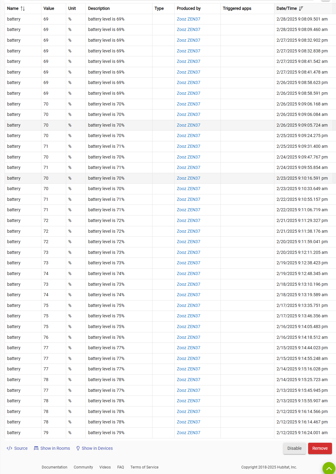

The one that just sits on my desk was at 79% on 2/12 and is showing 69% today. I dont have events any further back sorry. Its been a while since I charged it. I am using a LIR2032 I got off amazon since my sample device did not come with a battery from Zooz.

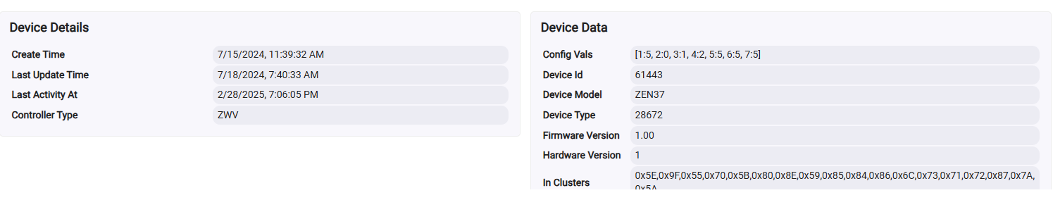

Never charged this since it was installed July of last year, it is 40 percent. I have another with create time 1/19/2024, it has been charged twice and shows 100 percent right now.
Mine was installed Sept. last year, very limited use and is still 100%.

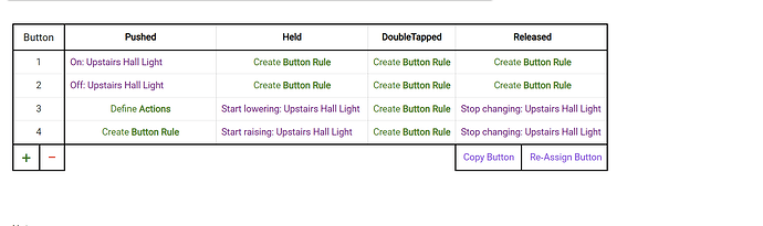

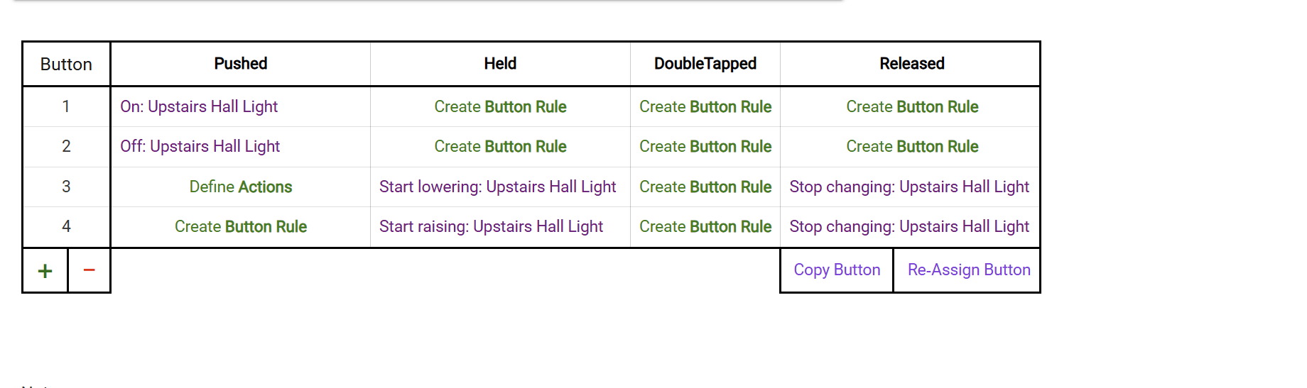

and works well with this rule to control a dimable upstairs hall light where the downstairs switch had no neutral and was wired weird..
