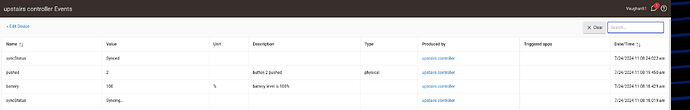

@jtp10181 :
A few questions about this driver and the device.
I seem to have paired it correctly, and I'm using the driver from the GitHub.
I've apparently "synched" it up, and it shows the correct number of buttons, etc.
It came up with 100% battery, but it appears that the device page doesn't reflect what button was pushed, unless I have the charging cable inserted.
In other words, if the charging cable isn't inserted, I can press button 2, but it doesn't show up in the device page, and the it doesn't show a color on the device. If I insert the charging cable, it does show up as a button press, and it does show up on the device itself with a purple color.
Yet, from the device page, it shows 100% battery:
Sorry if this is a silly question, but did you remove the protective plastic piece from the battery to allow the device to work without the cable or charge in the first place? (I know the battery says 100%, but if power is missing, it won't be able to send a report stating any different.)
I may or may not be speaking from experience.
Whoops...
I feel somewhat embarrassed...
Thank you @bertabcd1234 !
can relate :rofl:
Yeah it reports 100% when its plugged in with no battery attached.
