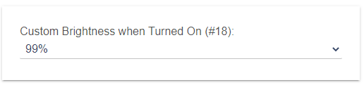

But, if it's off, there is already a preference that changes what the light does when turned on. The default is return to last brightness. I just changed it to 99%. There's nothing wrong with the behavior when the light is off.
It's when the light is on and dimmed that I want a single tap to go to full brightness. It sorta feels like this preference is supposed to do that but doesn't.

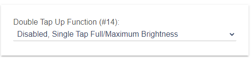

This is from my Zen27. If it's not supposed to behave like what I'm talking about, it makes this setting kinda redundant and pointless.
Why would I disable double tap to full brightness and enable single tap to full brightness if that only works when the switch is off since that is already controlled by a completely separate parameter?
The custom brightness setting isn't really designed for use with full brightness. It was added to accommodate night light scenarios to turn the dimmer on to a custom brightness with a single tap at selected times of day or night. We then added the night light mode to simplify the programming but the custom brightness is still there for more elaborate scenarios.
If you're ok with using single tap to full brightness regardless of the position of the switch, then using the button automation @jtp10181 described would do the job.
