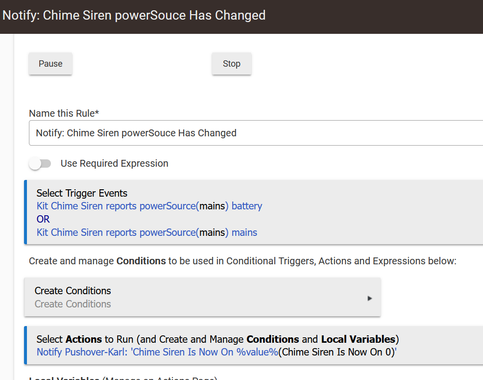

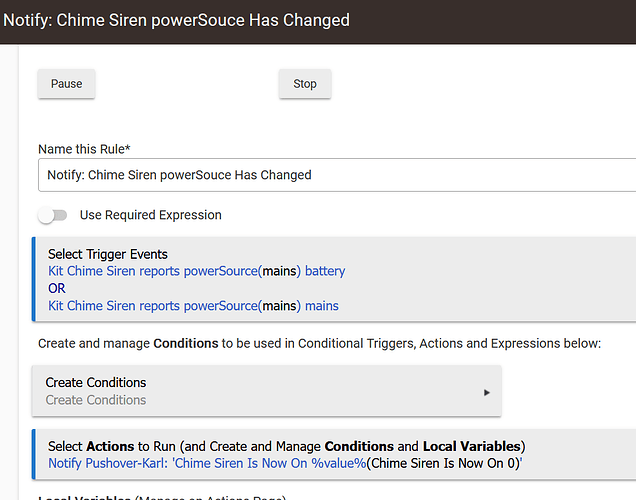

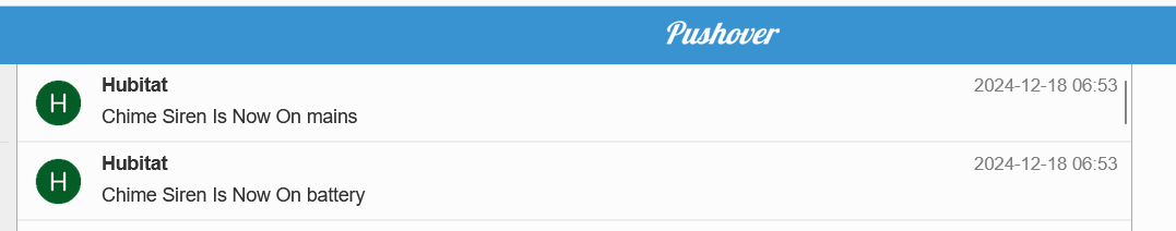

You have to use CustomAttribute as a trigger in a rule.
Here is what I have for my Ecolink Chime Siren; I assume this device has a similar custom attribute.

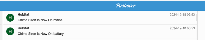

Pushover has been good for me.
Uncertain of why the %value% was 0, I just unplugged and replugged the Chime Siren,
It still works. :slight_smile:

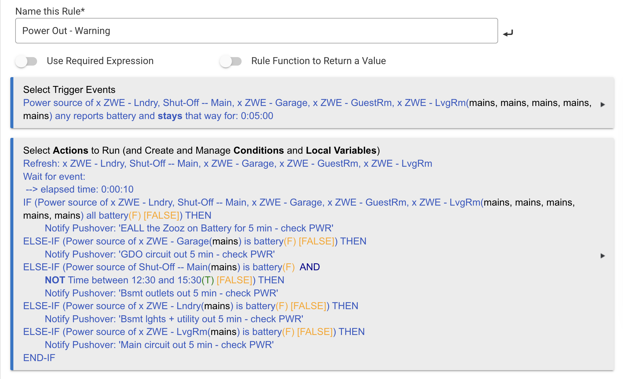

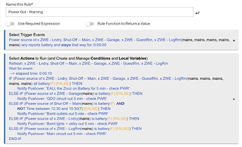

I have 4 Z38s and a Titan w/ battery pack, so here's my alert rule as another build to consider...
These devices are placed to monitor the main circuits in my house. Since I sometimes intentionally shut down a circuit for something quick, I gave myself a 5-minute window in this rule. I built in a Refresh after the 5-minute wait just to help confirm what's afoot before sounding the (proverbial) alarm.
My hub is on a UPS, so I also use the Power Outage Manager app Jeff mentions above -- that gives me a backup notification if all power is out, and when power is restored.

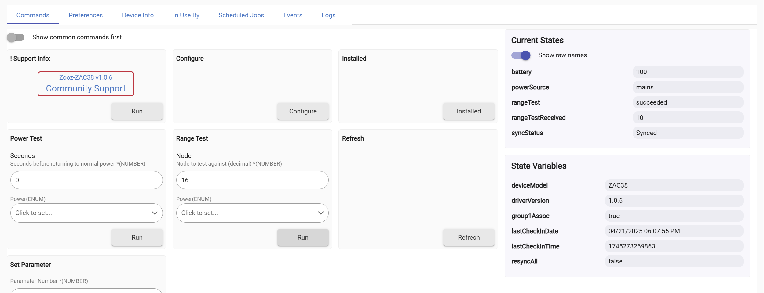

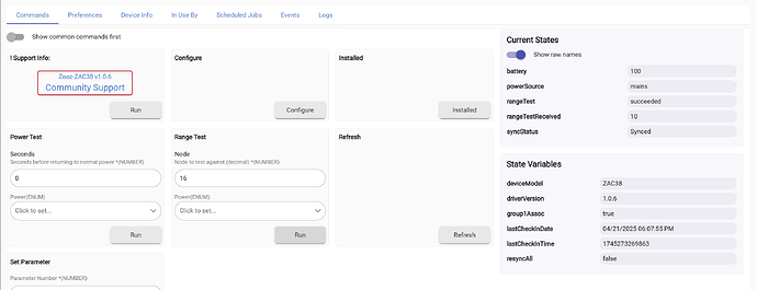

is it possible to add the range and power level test like the aeotec extenders
i hacked changes to the driver (sorry lol) appologies to denny page where i got the code from...
seems to be working.. not sure if you want me to send you or post it or do a pull request or do nothing..
thanks
For something like that you could send me the full code in a PM if you want. Link to github or pastebin would work. Then I can do a diff and merge it, and I may adjust it slightly to fit my code style if needed.
