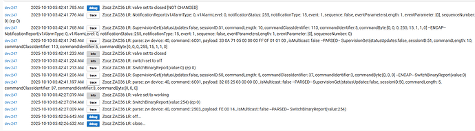

Just in case this sheds any light on the problem, here is the trace log after sending the command to close three times in a row, waiting 20 seconds or so between each command:
As you can see, the valve definitely "knows" it is already closed, as it does not run its motor and does not change status to "working".
So even though the valve knows it is closed, it keeps reporting "open" as its status, to the driver.

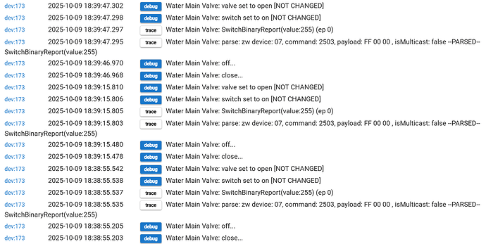

Its odd you are not getting the notification reports along with the switchbinary. Mine was sending both. One last thing, try doing a refresh after it is closed, see what gets reported and see if you get the notification event for the open/close.

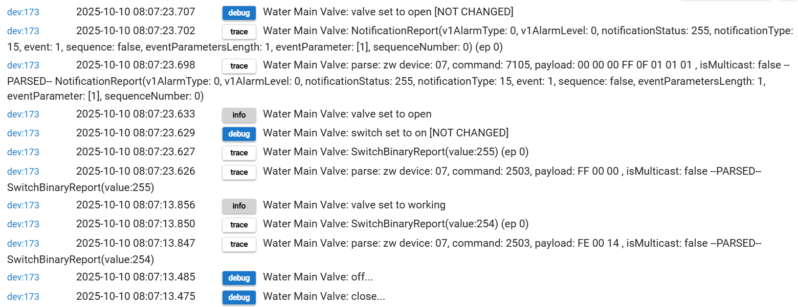

Here my logs on ZIP when closing (from opened). It sends the final notification when it does the double beep beep when it is all done.

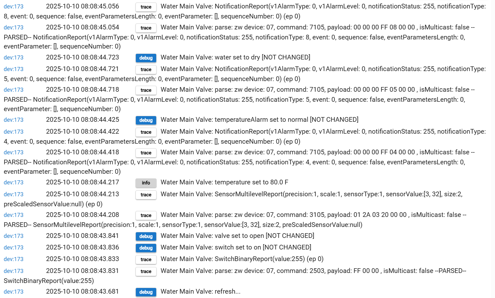

Doing a refresh after closing the valve does not change the reporting of it being "open".
Nor does it trigger a notification event.

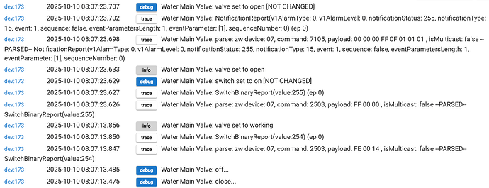

However, here I have closed the valve, and there IS a notification event:

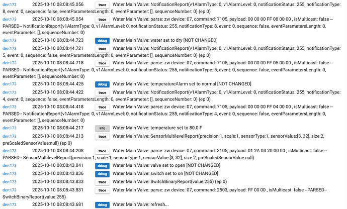

Then I refreshed:
It still reports "open".
