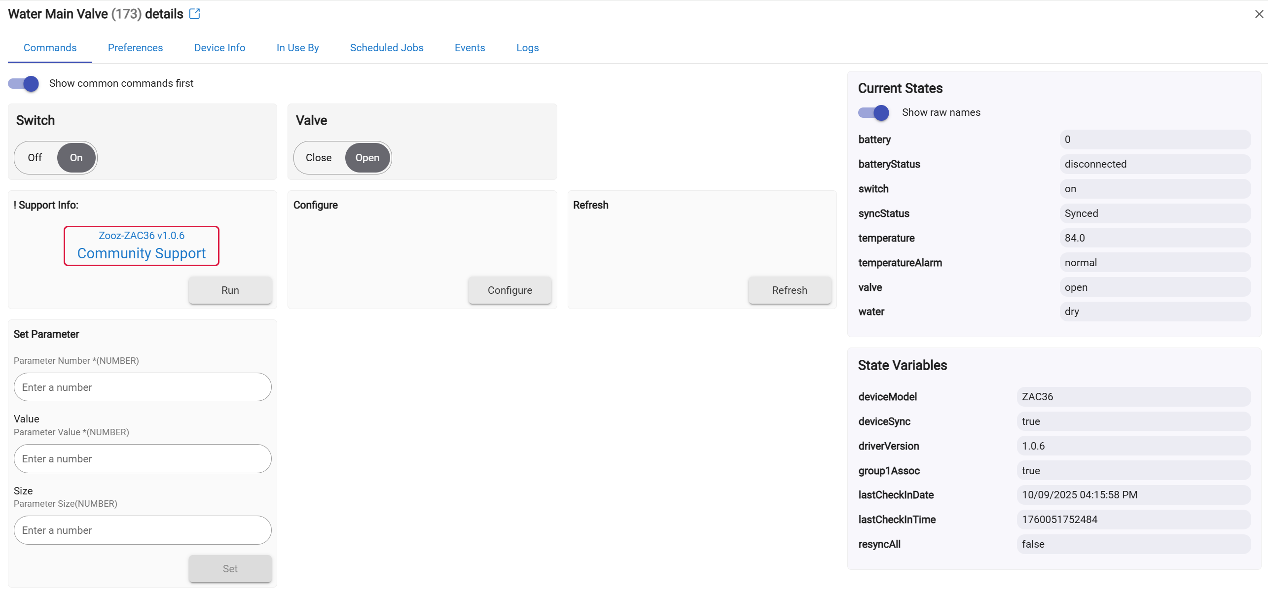

I had installed my new ZAC36, changed to this community driver, and I believe it was working normally. Then I had to exclude and delete all my Z-wave devices to mess around with SmartStart and my ZSE42 leak sensors. After I got the leak sensors included properly again, I factory reset the Titan, re-calibrated it, and re-included it.
But now I'm seeing this strange behavior whereby the Current State of the valve, when it is initially open, then I command it to close, first changes to "working", then to "open" again. And then the Valve command button still shows Open. However in reality the valve HAS closed.
Oddly, using the web page in Chrome on my desktop Windows computer, the behavior is as described above. This means there is no way to open the valve after closing it, because the Command button immediately goes back to showing Open, and does nothing when you click on it (either left or right side of the button):
Whereas, using the Hubitat web page in Chrome on my Android phone, there are separate buttons for Open and Close, so I can use them to open, even though it thinks the valve is still open.
I've forced a recalibration from the Closed state, but this hasn't helped.
What could be causing this odd behavior?

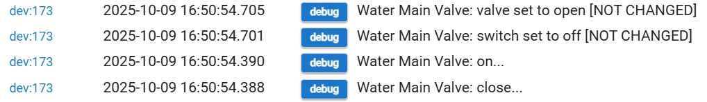

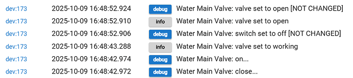

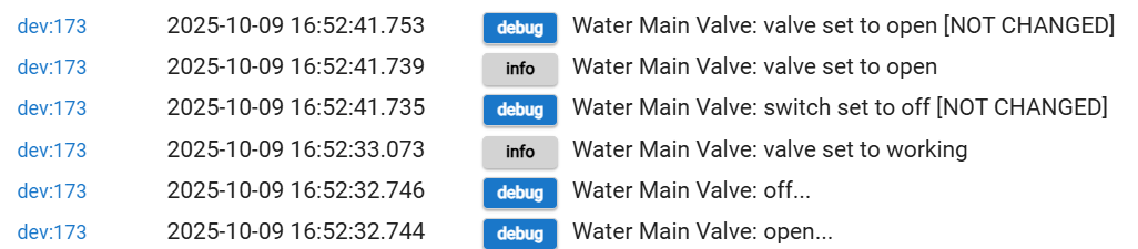

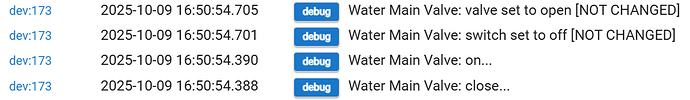

Here are the log entries starting from the command to close (with valve initially open):
If I then click the Close command:

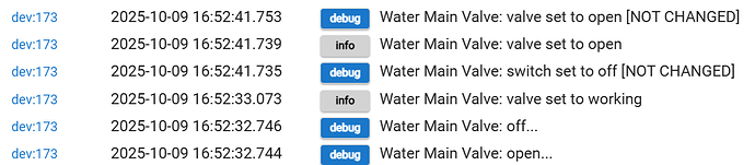

Clicking Open does nothing. However, after clicking Open using the browser interface on my phone:
So it seems that the valve itself knows it's closed, after executing the command to close; because if you command it to open, it does so. But the driver seems to get confused, and doesn't get the information that the valve is closed, after telling it to close.

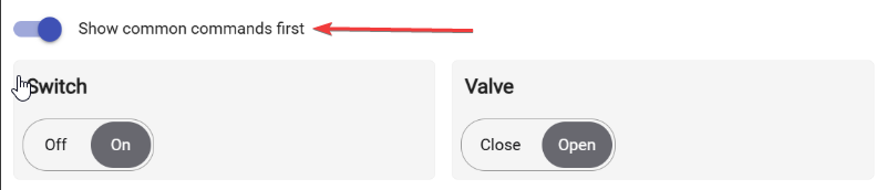

You can turn off this option to expose the command buttons

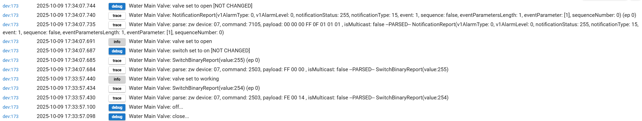

Turn on TRACE logging and get logs again.
Great; thanks! I hadn't realized what that "Show common commands first" was for!

With Trace logging, here is what I get after a close command:
And then here is what I get after a subsequent open command:
To my untrained eye, it appears that the Titan is sending the exact same trace message after closing the valve as it does after opening the valve...
I wonder if I should try forcing a calibration again.
