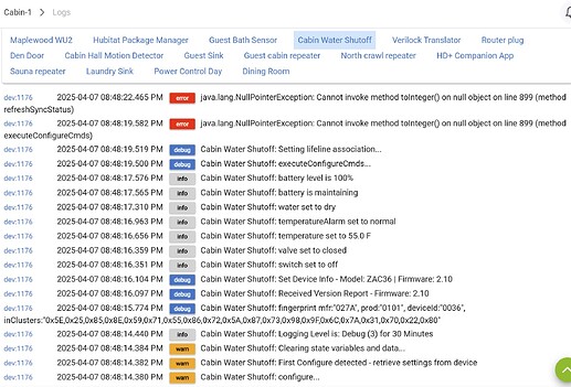

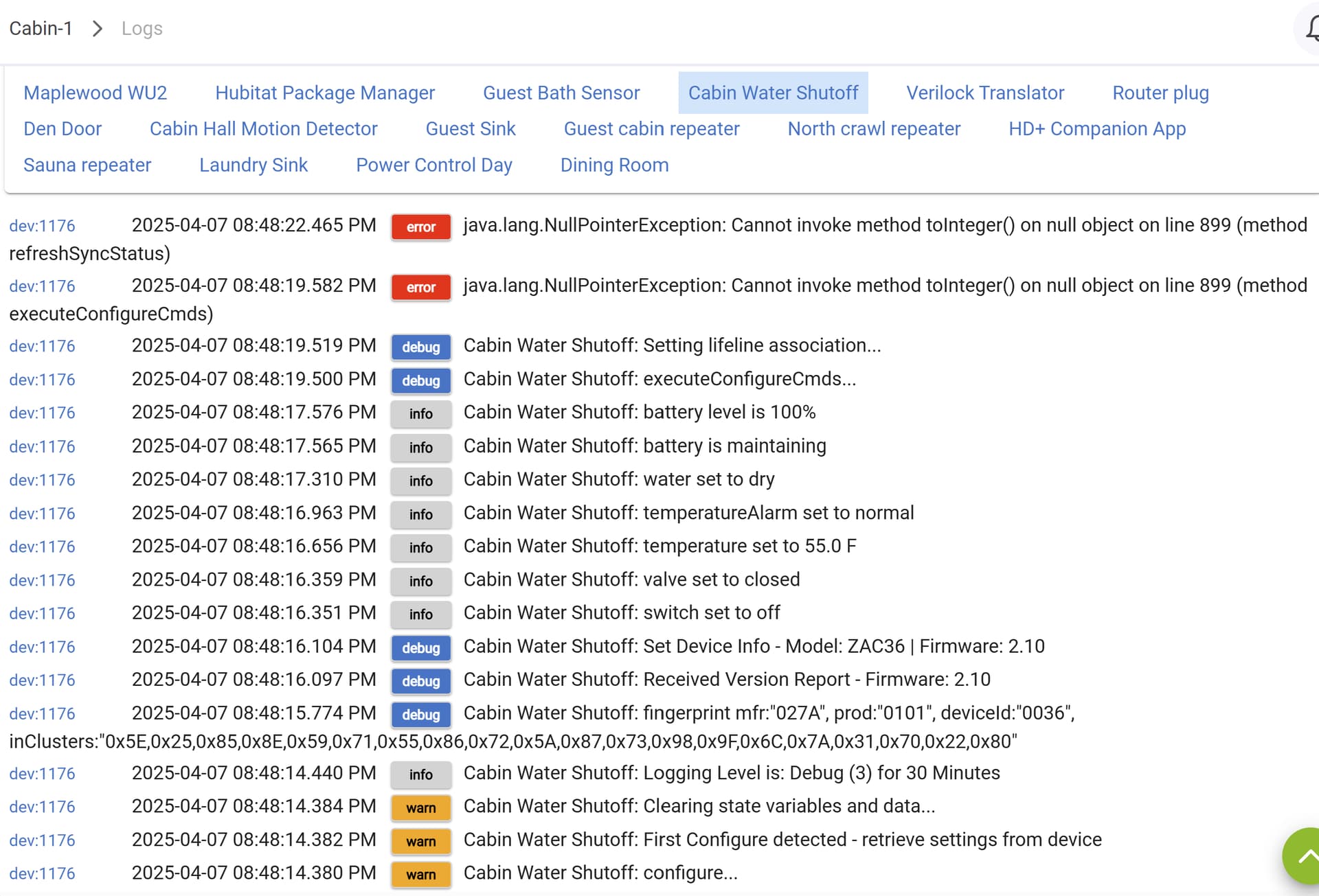

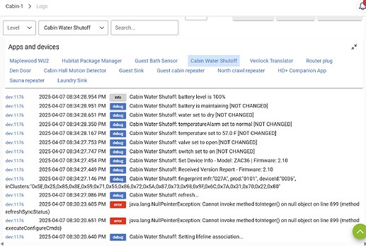

Getting this Java error when hitting Configure:
[edit] Another log of the Config error:

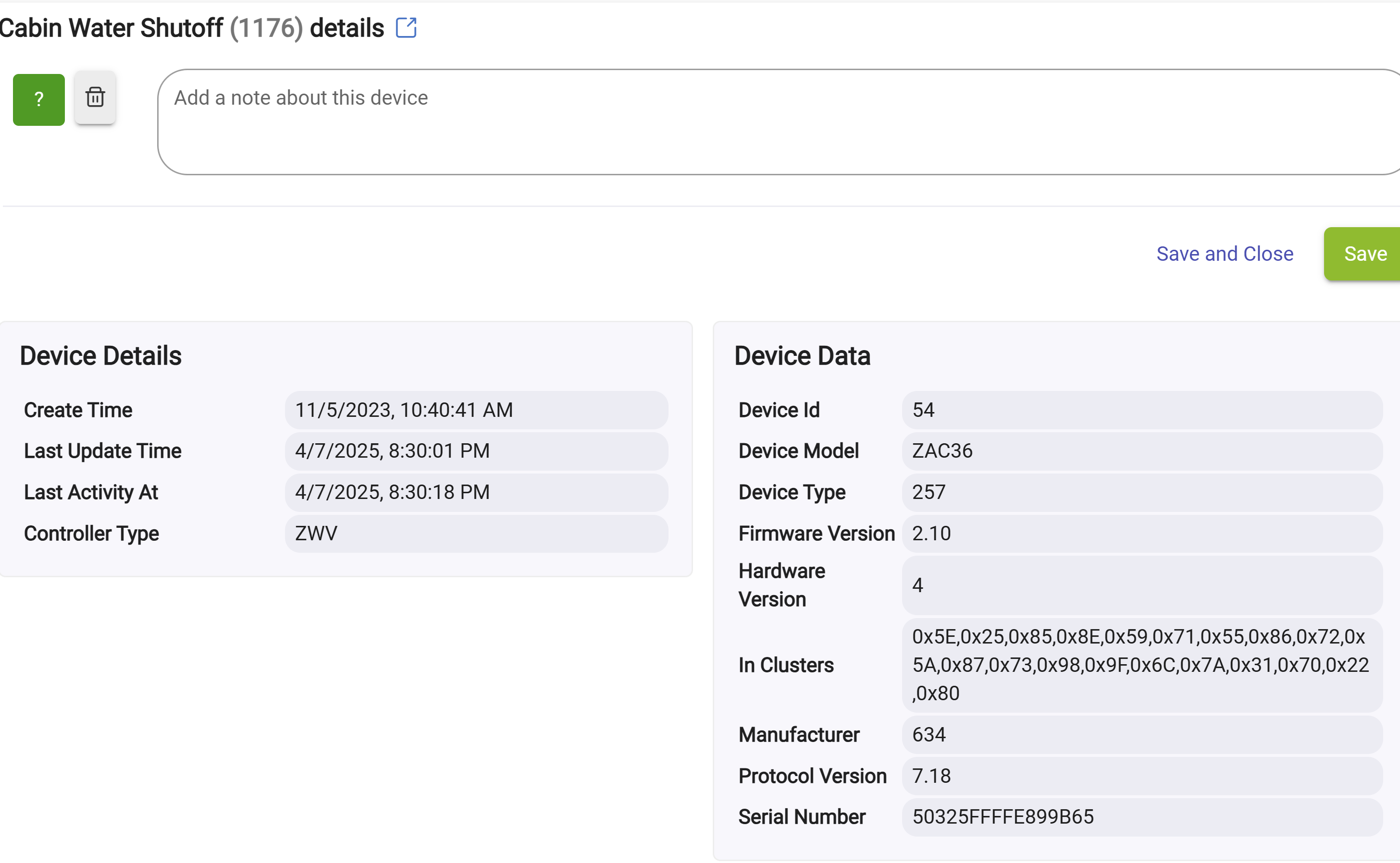

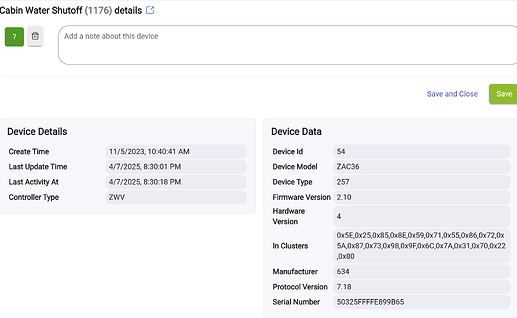

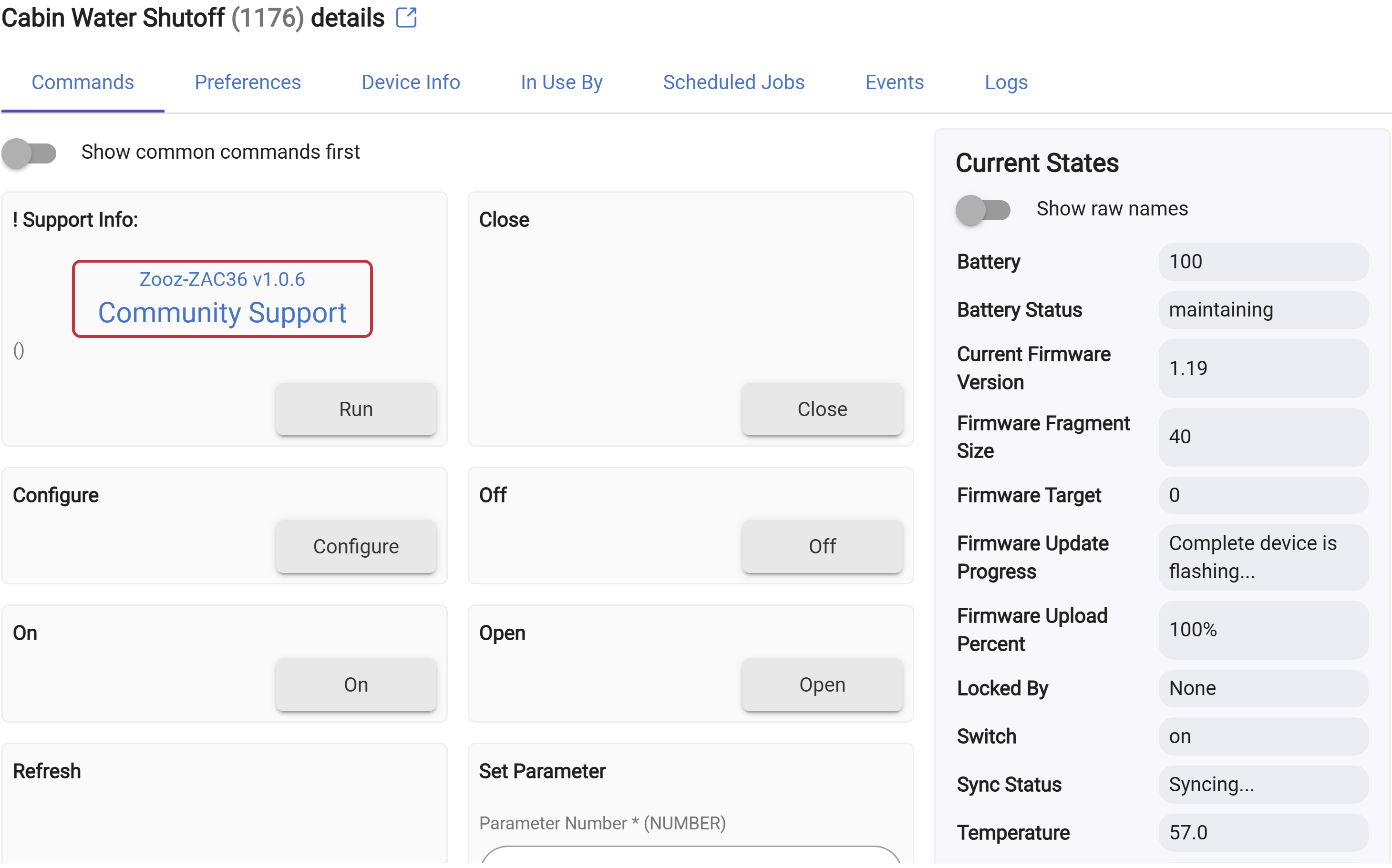

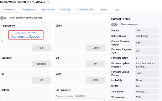

Also seeing a conflict in what firmware version it reports. On the Commands page I get 1.19 and on the Device Info page I get 2.10 (which is probably correct given the reported hardware version of 4):
[edit 2]: Maybe the data on the Commands page was leftover from the firmware flashing. It eventually cleared when I used the "Device" driver to clear states.
Yes, it was
I think the errors might be from values on the settings which are not set at all (blank). It should be the Temperature Units for Settings setting. Make sure it is set, save, and try again.

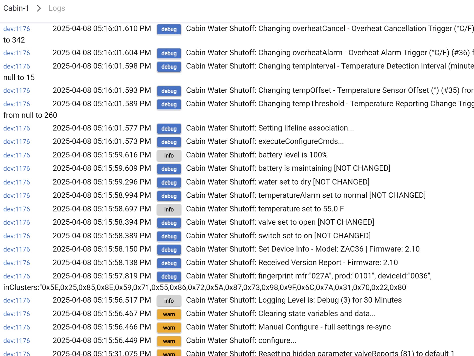

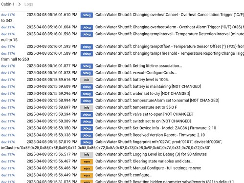

That particular setting appeared to be set on the Preferences page, but I selected F anyway. After I hit Save, parameter 81 was the only that showed in the logs. See below. Configure worked this time with no errors. There were a number of other parameters from 34 on up that went from null to a value. Thank you.
