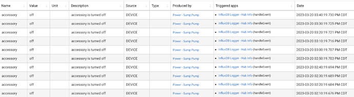

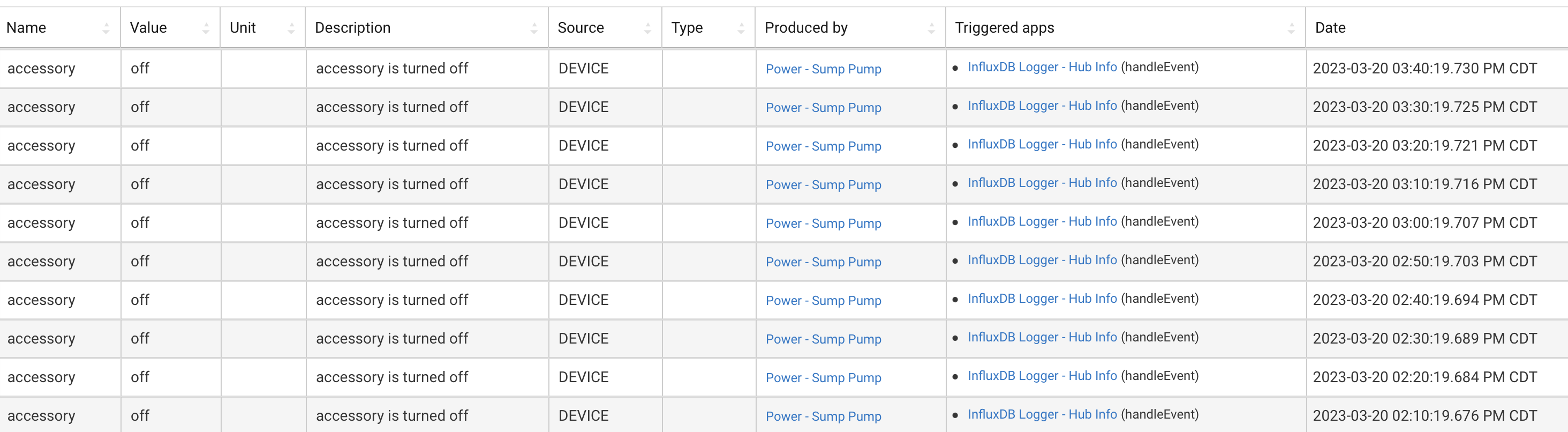

I'm using your great ZEN15 driver. I'm using the 'accessory' setting. The setting is generating events even when the power state is not changed. The events are based on the time-based schedule for wattage reporting. Is it possible to suppress those non-state changing events? Thanks
Where are you seeing the events? Yes the driver is sending to the hub but I am not forcing it. The driver should only log it when it is a state change. The hub should be suppressing the duplicated events from the event log and I did not think it would trigger RM either in this case?
On the device events page. It's most a visual issue of filtering out the non-real events. Not sure about RM.
Its not supposed to do that, the hub should be filtering those out and not even posting them to the events. I will have to check it out, something odd is going on there.

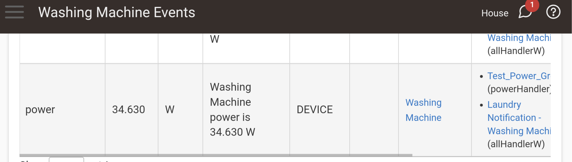

All the metrics show up on the device page and how often they update will depends on your reporting settings. With Z-devices there is no real-time or live data, it has to be reported from the device to the hub.

The reports are real-time for when the report comes in. So, periodically, based on the device settings, the plug will send an 'event' to the hub. That means the plug says "what is my power reading right now" and sends that in a message to the hub. The driver, in this case, has code to decipher that message. To see these, you go to the device page and click on the 'events' button. There is a max number of events retained for each device. The settings are max per event type (power for example) and max per attribute (power is also another example). There's also a threshold for how many events before the hub thinks that the device is sending too much traffic. Like if you sent power to report with every 1W change on the fridge, you'd probably end up with an event/report about every second as the load is pretty dynamic
The driver, optionally, can also send a log message with the event. Whether or not that happens and what the log message looks like is up to the developer of the device driver.

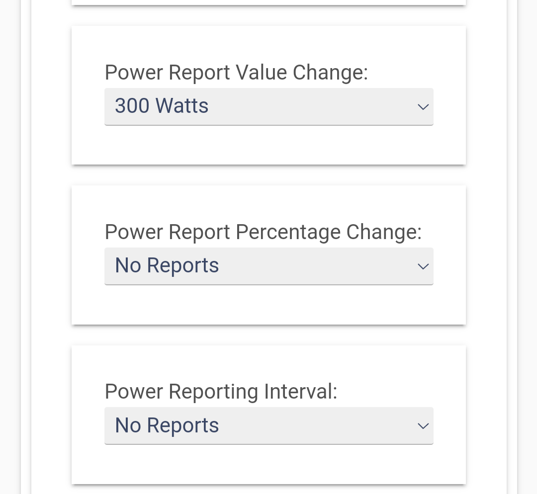

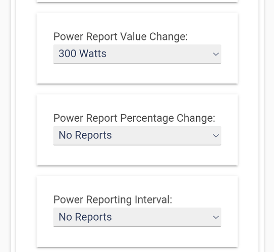

Zooz plugs are configurable for power reporting. You can have it report based on the number difference from the last power reading (power report value change), a % difference in change, or on a set time based interval.
Let's say my reading right now is 500W. I set the value threshold to 100W, percent to 10%, and time to 30 minutes. The device will send an event every 30 minutes regardless of the value. If it changes to 551W, I hit the 10% threshold and will get an event. If the value change again to 655W the. I'll hit the value and percent thresholds and will get an event
