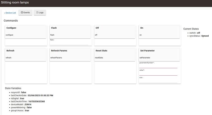

@jtp10181 ... I have a ZEN14 controlling two lamps, that are bound to a wall switch using switch bindings. I seem to have an issue where the status reflected in Hubitat (on/off) gets out of sync with reality on one or both outlets ... and then rules or dashboard tiles can no longer control the confused output .. they just seem to get stuck. If I go into the child devices and refresh them to poll the device and re-sync the state of the confused output, everything starts working again. Sometimes its both, sometimes it's just one or the other and if it's only one, the other continues to work just fine until it eventually gets stuck too. I updated to 1.1.2 when you released it hoping that might have fixed the issue, but it had no impact.
This is a very frequently repeating issue so if you have any suggestions or thoughts, I'd appreciate the ideas.

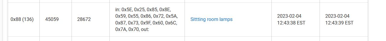

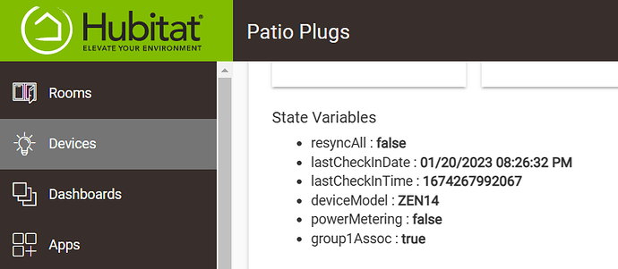

Post a screenshot of that device from the Zwave Status page.

Also get screenshots of the zwave details page. I am suspecting the devices change states but the response never gets back to the hub, and thats where the problems start.

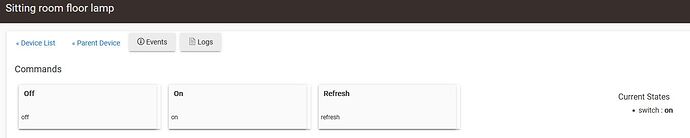

Sending an "off/on" from the device page does re-sync things like refresh does and everything works again ... but in either case, it only works for three-five cycles before it breaks again.

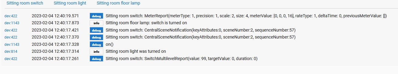

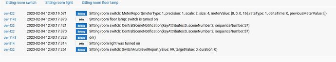

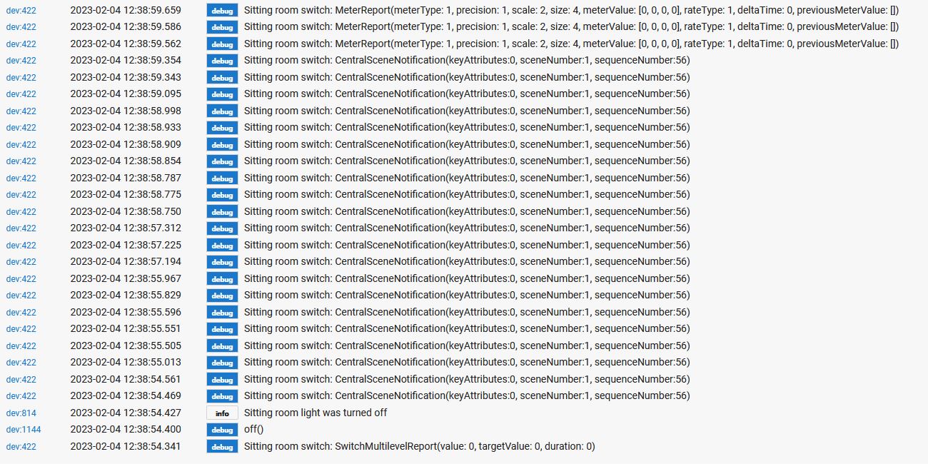

Here are logs when it works turning off ...
The following attempt, only one turned on ...
And after the only the one was working ...

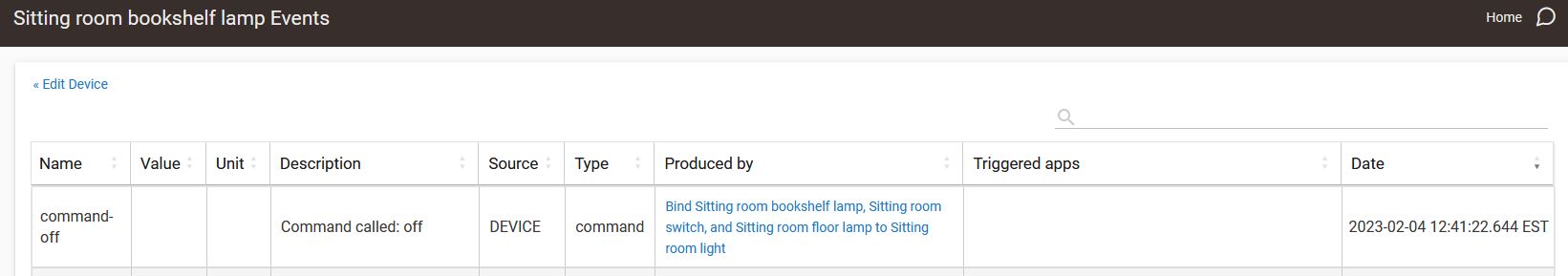

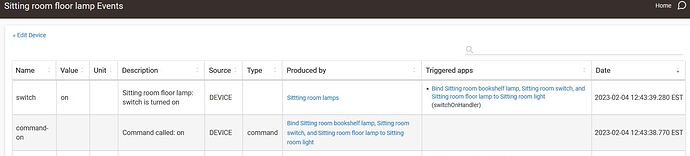

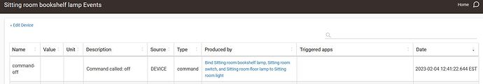

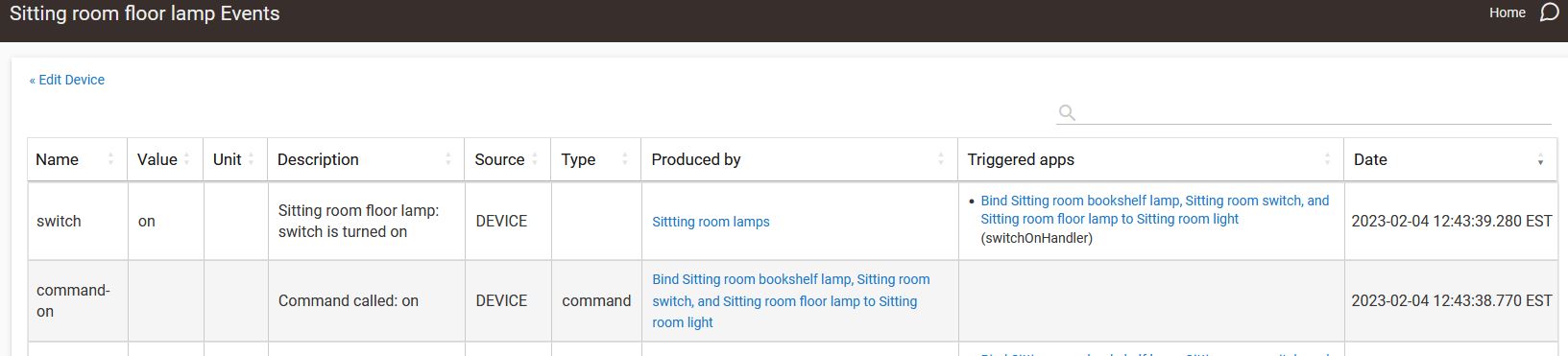

In the events, one child shows the events, while the one in the stuck state doesn't even reflect them ...

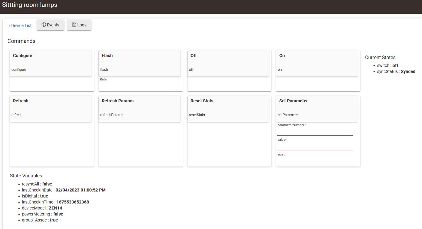

And for the details, I have a C5, so they don't have as much useful info ...

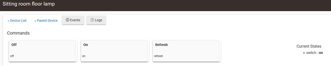

Right now, both children are physically off, but the child devices reflect them as being on. The parent correctly reflects its overall state as off.
Lastly, the children are using "Generic component switch" as their type ... just to be sure that is correct.

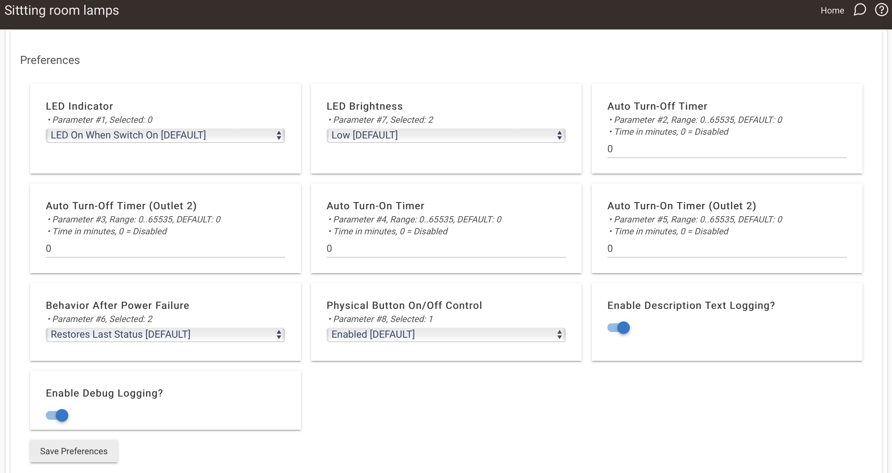

Looks like you turned on debug for the switch, probably dont need that. Did you have debug logging on for the parent ZEN14 device? Looks like it was only enabled for the child(s). I think the parent debugging would show more useful info. You could also edit the driver code and go all the way to the bottom to enable the trace logging which will log pretty much everything.

Debug logging is/was on for the parent and both children.

Your first log you posted before only contains one entry from the device in question 1144. If you are using my driver and the parent device had debug on there should be a "componentOff" log from the parent device right away any time "off" is commanded on the child device. Then the parent sends the zwave command to the device, and the device should respond, resulting in more logs.

It is version 1.1.2 of your driver and debug is confirmed on for the parent ...

The parent debug logging will time out after 30 minutes, not sure if that's why you are missing that logging? Or was it filtered out? I don't see any logging from the parent device in your posts.

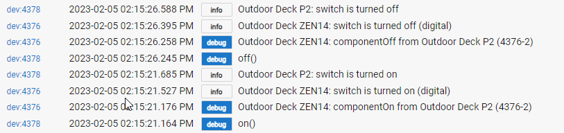

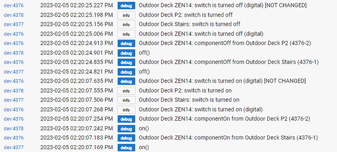

Here is logging of an on then off from the child device with all logging enabled on child and parent.
Also made a quick group to test turning both on/off at the same time. Also works fine and you can see much more logging than you are showing.
I do see one possible issue, if a child is off (or on) and I send the same command to it again, the plug only reports back the parent state and not the endpoint/child state. I am also noticing the parent state is just mirroring whatever that last endpoint change was, if I turn one ON the parent reports On, if they are both on and I turn one off, the parent reports off. Makes no sense really. I think Zooz changed something with a firmware update because I don't remember it doing that when I made the driver.
I don't really think any of this would be causing your issue though. At this point without more logging all I can suggest it is a z-wave mesh or device issue and the reports are not making it from the device back to the hub.
